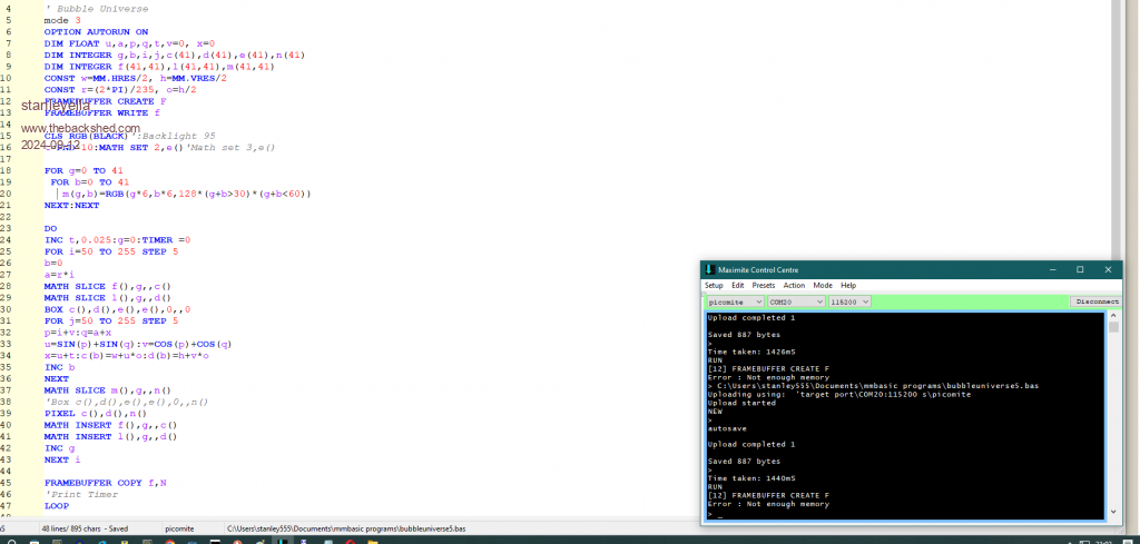

Posts: 2807
Posted: 09:06pm 11 Sep 2024
' Bubble Universe
mode 3
option autorun on
Dim Float u,a,p,q,t,v=0, x=0
Dim Integer g,b,i,j,c(41),d(41),e(41),n(41)
Dim Integer f(41,41),l(41,41),m(41,41)
Const w=MM.HRes/2, h=MM.VRes/2
Const r=(2*Pi)/235, o=h/2
FRAMEBUFFER CREATE F

RUN
[12] FRAMEBUFFER CREATE F
Error : Not enough memory
more pico2 stuff that worked 2040. stan?
Posts: 9039
Posted: 07:03am 12 Sep 2024
Don't create a framebuffer in Mode 3 seems to be the answer. At least, not unless your program takes little RAM, so no big arrays.
