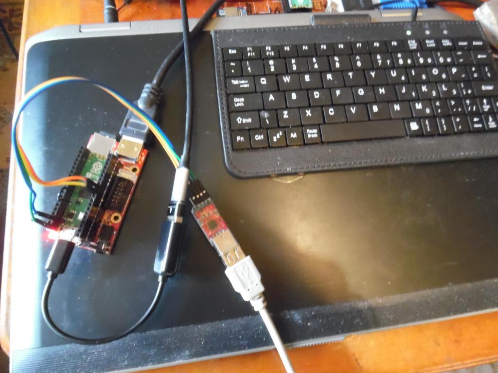

Anyone using olimex 2350 hdmi usb?
I ask because when I flash the hdmi usb it runs as vga hdmi usb and can't reset olimex.
When I flash pico hdmi it works
> option list
PicoMiteHDMI MMBasic Version 6.00.00RC2
OPTION AUTORUN  ON
OPTION FLASH SIZE 4194304
OPTION COLOURCODE ON
OPTION KEYBOARD US
OPTION CPUSPEED (KHz) 315000
OPTION DISPLAY 24, 80
OPTION HDMI PINS  1, 3, 7, 5
OPTION MODBUFF ENABLE  192
OPTION PLATFORM OLIMEX
hdmi usb firmware
I got usb to ttl connected to gp8,gp9 and flash hdmi usb says vga hdmi usb but usb to ttl works connected to win and terminal option list but option reset olimex says invalid board

How  many times do I need to say the same thing? - you have asked the same before and I explained then
OPTION RESET OLIMEX is not valid for the HDMIUSB firmware only the HDMI firmware. The concept of OPTION RESET is that is configures a board WITHOUT any other additions to work "out-of-the-box". The Olimex needs an additional USB/UART to work as a USB host and therefore is not supported in HDMIUSB firmware.

thanks. got it. I thought it worked on one release but with trying so many versions I may be confused. maybe olimex 2040.
olimex pico2 hdmi is easy to try hdmi graphics.
pico2 vga usb is interesting to with new graphics.

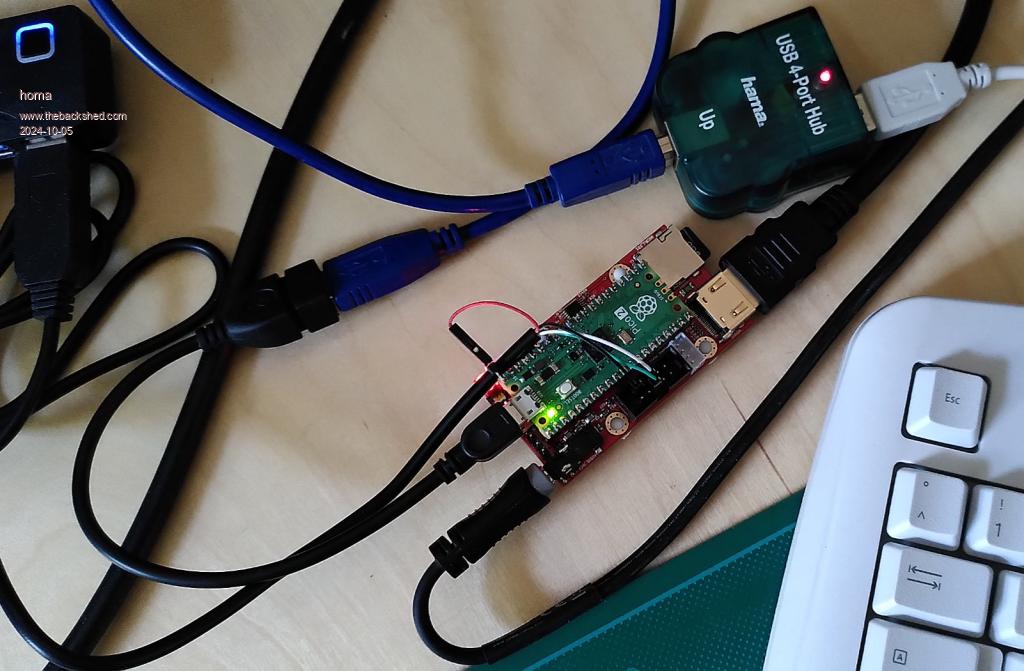

I use it.
OLIMEX Connector
1 3.3V  -- 3.3V p36
2 GND   -- GND  p38         -- ok black
3 TXD   -- GP20 p26 com2 tx
4 RXD   -- GP21 p27 com2 rx
5 SCL   -- GP9  p12 com2 rx -- ok green
6 SDA   -- GP8  p11 com2 tx -- ok white
7 MISO  -- GP4  p6  com2 tx -- ! sd
8 MOSI  -- GP7  p10         -- ! sd
9 SCK   -- GP6  p9          -- ! sd
10 SSEL -- GP5  p7  com2 rx
> option list
PicoMiteVGA MMBasic USB Edition  6.00.00RC4
OPTION KEYBOARD GR
OPTION CPUSPEED (KHz) 372000
OPTION DISPLAY 30, 80
OPTION RESOLUTION 1280x720
OPTION DEFAULT FONT 3, 1
@Peter: an “OPTION PLATFORM OLIMEXUSB” would be really nice and desirable.
You can also do without a console (COM2 ), then I supply the board with a USB power supply via the USB port underneath and have a small standalone computer :-)

Just set the options by hand - it isn't realistic to add every variant of how a board might be used

@homa. Yes, manually set options works! Thanks.
