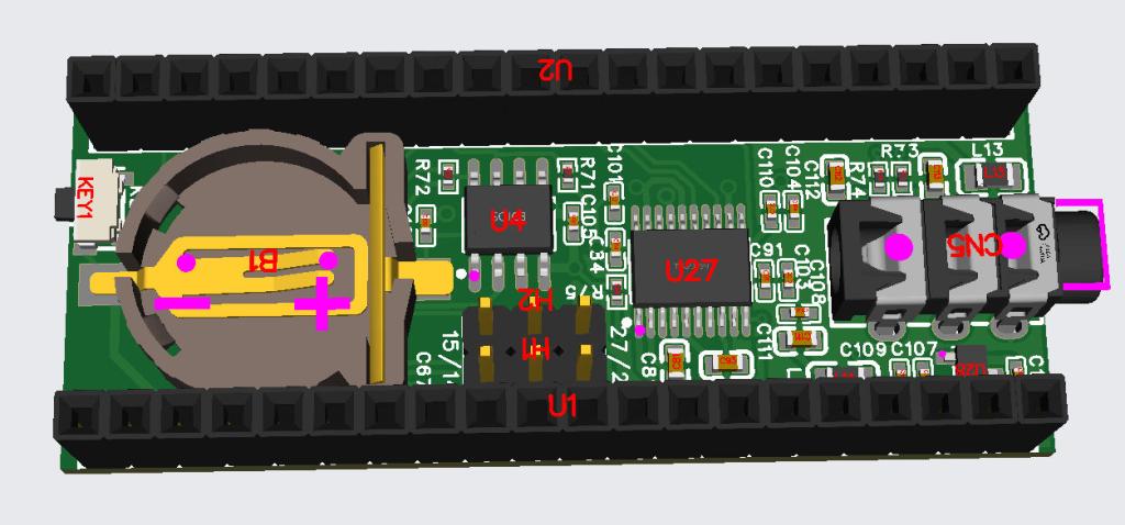

Another quick design
Schematic
ef24a008-bf00-4508-9bfe-93c89e591622.pdf
OPTION AUDIO I2S GP6,GP5
OPTION SYSTEM I2C GP14, GP15 (or GP26,GP27)
I'll get some made to test the I2S bit as this is a new module. Assuming all OK I'll post the gerbers etc.
Plug a Pico2 into this and this into a Waveshare display and you have everything needed for a high quality music player

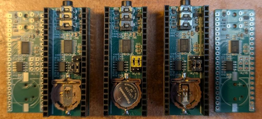

Posted: 01:06pm 04 Feb 2025

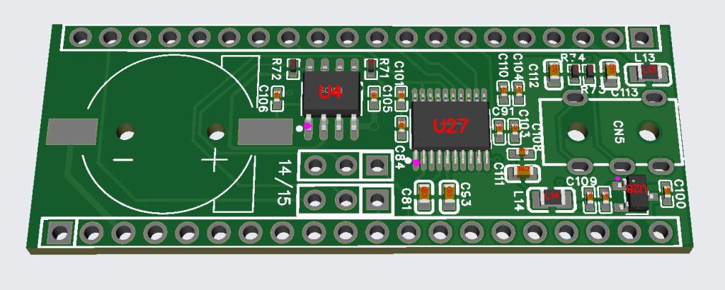

The boards have arrived and work perfectly. I2S audio and DS3231 RTC on a simple Pico "Hat". Since getting these built I've also added a miniature reset switch but you can omit that on the BOM if not required.
NB: the BOM includes simple 20-way headers. I omitted these and used long-pin variants so the boards can be stacked. I can't find a part number for these on JLC/LCSC. As always, omit any parts you prefer to solder yourselves to save cost - Audio jack/battery holder, jumpers etc.
The underside of the board specifies the option commands need to configure.
The PCM5102A I2S DAC runs off its own linear regulator with extensive decoupling/filtering and audio quality is superb.
The boards could be hand soldered but use numerous 0402 parts so pretty tricky.
OPTION SYSTEM I2C GP14,GP15 or OPTION SYSTEM I2C GP26,GP25
NB: I will be enabling I2S audio on all Pico variants (RP2040 and RP2350) in a future release as it is SO GOOD
