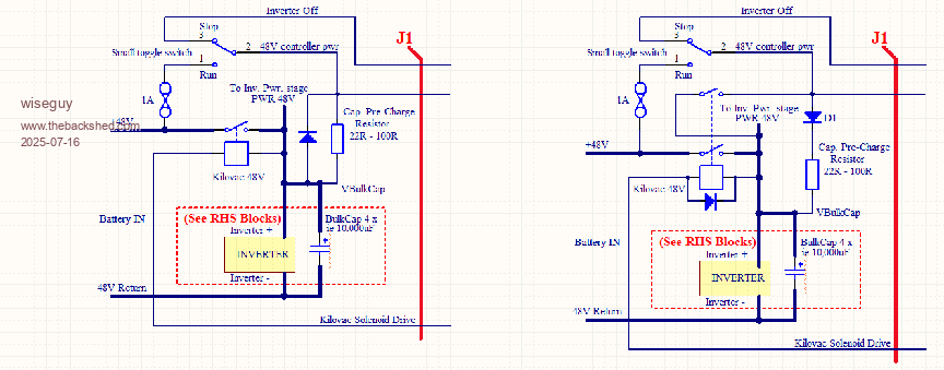

This was originally posted under MAB1's wiseguy inverter build here  but it probably belongs here
It may be helpful for some to discuss the startup circuit evolvement & issues.
After re-reading Mabs comments I decided to take a trip back to earlier versions of startup to see what changed. When the controller was first designed all the voltage levels for the bulk capacitor voltage and Battery/Inverter main supply voltage were done via analog comparators. Thresholds were set by resistors and were a bit arbitrary. From memory if the bulk capacitors were within ~ 1 volt of the supply voltage the contactor was ok to close.
Once Peter obliged me by modifying the inverter Nano code to include startup checks and validation checks, that could be user modified by a register value, such as voltage drop over the contactor contacts etc, the startup circuit - particularly the V+ (48V typically) became more critical as any voltage drop between the Vbat and controller 48V input could intefere with contact closure at startup and monitoring the Vdrop over the contactor contacts when closed.
In trying to keep the startup circuit "simple" various insertions of diode and startup resistor combinations were tried, but the real problems was that in trying to simplify parts count it was a bit like putting lipstick on a pig. Somehow with a brain fart my schematic shown a few posts back from Mab 1 disobeys step 6 so the Nano will not ramp PWM down to zero due to a whoa camel stop event. (whoa camel was first mentioned a long time ago see here). The 48V is removed from the controller when "stop(off)" is selected due to the series diode - not good! (maybe also explains Mab's noisy contactor), the KeepIS configuration still feeds Vbat via the precharge resistor so the controller can reduce spwm to zero and shut down properly. Switching the run switch to stop causes the Nano's Vbat sense input to go low which reduces spwm to zero the same as the Vbat becoming too low.
Fundamentally the main requirements are.
Inverter is galvanically isolated from Vbat, now set the on off switch to "on"
1) Supply VBat (48V) directly to the controller so the nano sees Vbat exactly.
2) Simultaneously apply precharge to the bulk capacitors
3) When Vcap is high enough ~ close main contactor and run the inverter.
4) While inverter runs, monitor Vdrop across contactor (Vbat to Vbulk capacitor)
5) Now we want to stop the inverter, so set the on off switch to "off"
6) We need to maintain contactor closure and 48V to the controller.
7) Whilst contactor closed and controller has 48V, the spwm ramps back to zero.
8) Now with spwm=0, open the contactor and 48V is removed from the inverter & controller & contactor.
9) Ideally, there should be no sneak path from the Bulk capacitors back to the controllers Vbat input.
With the KeepIS modification the controller is still connected/powered from the bulk capacitors after the main contactor opens, until their voltage has drooped enough to not support controller/display operation. The main benefit here is that the bulk capacitors are slowly bled away, however it may be possible for a few "flickers" as capacitors fluctuate towards zero.
The first circuit shows a working configuration that I previously used, very similar to KeepIS.
I am not advocating to use the second circuit it just shows an ideal solution.
The second circuit could use either a spare contact set that some of the contactors use or alternatively a second small 48V relay driven in parallel with the contactor, untested but I believe it provides the required isolation from the bulk capacitors and the Nano controller.
Note: the second circuit's bulk capacitors would stay charged for a very long time.
Also note the prudent inclusion of the slow blow 1A fuse to the small toggle run/stop switch battery input (no doubt many have already done this).
Apologies for the stuff up of what looked like a simple problem which got progressively worse.
In summary unless you are having display flicker type problems IF using the KeepIS configuration dont bother with schematic 2.  Anyone who has built their inverter with my schematic in Mabs post on the previous page should bridge/replace the diode with a short and supply the contactor direct from PWR48V (same as Vcap).
Edited 2025-07-18 10:54 by wiseguy

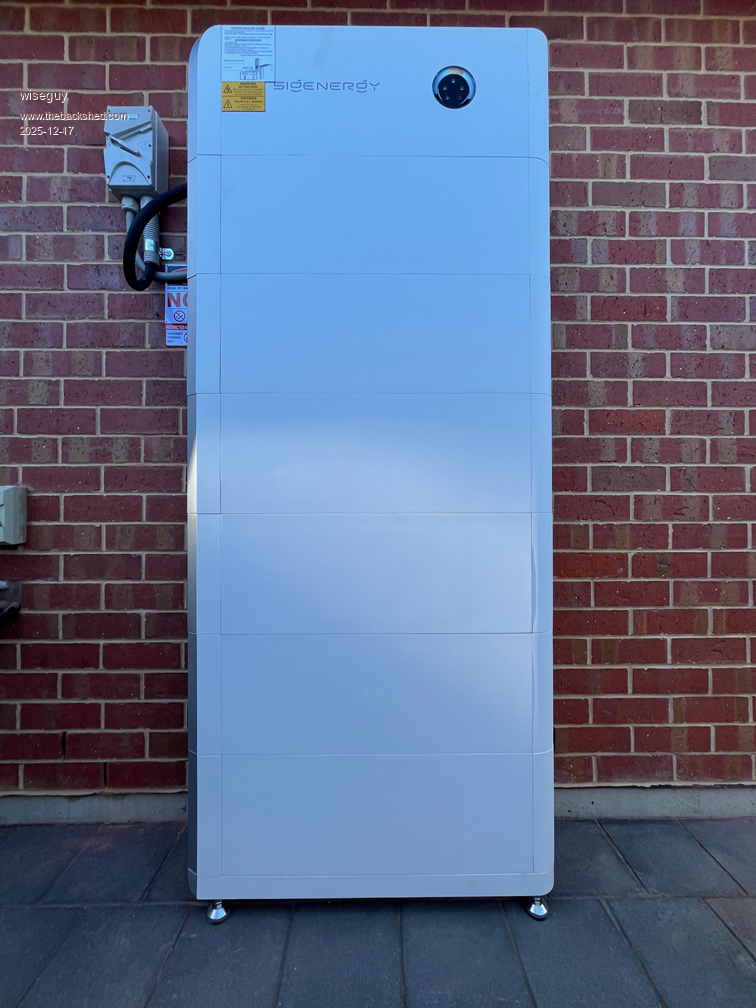

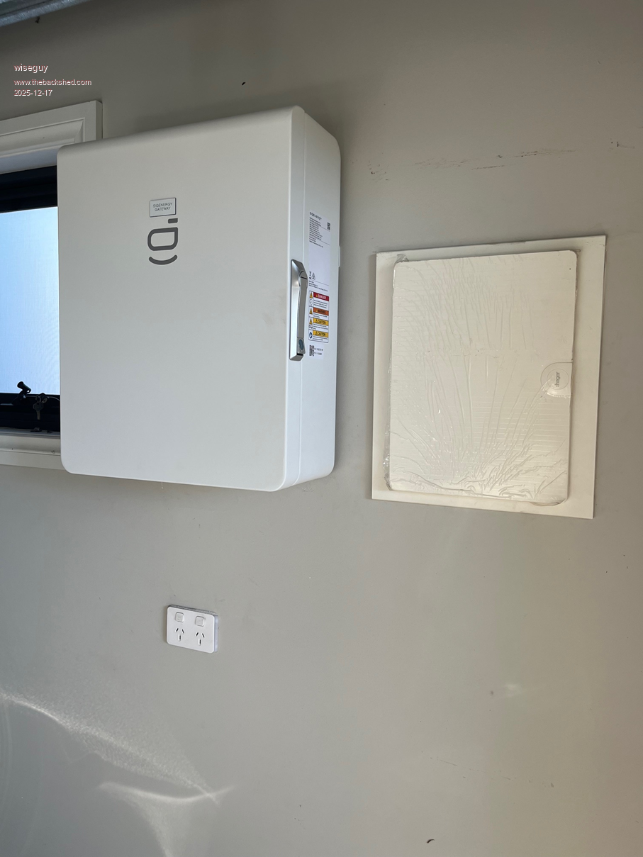

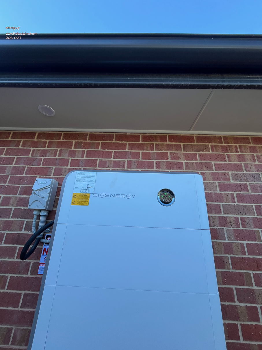

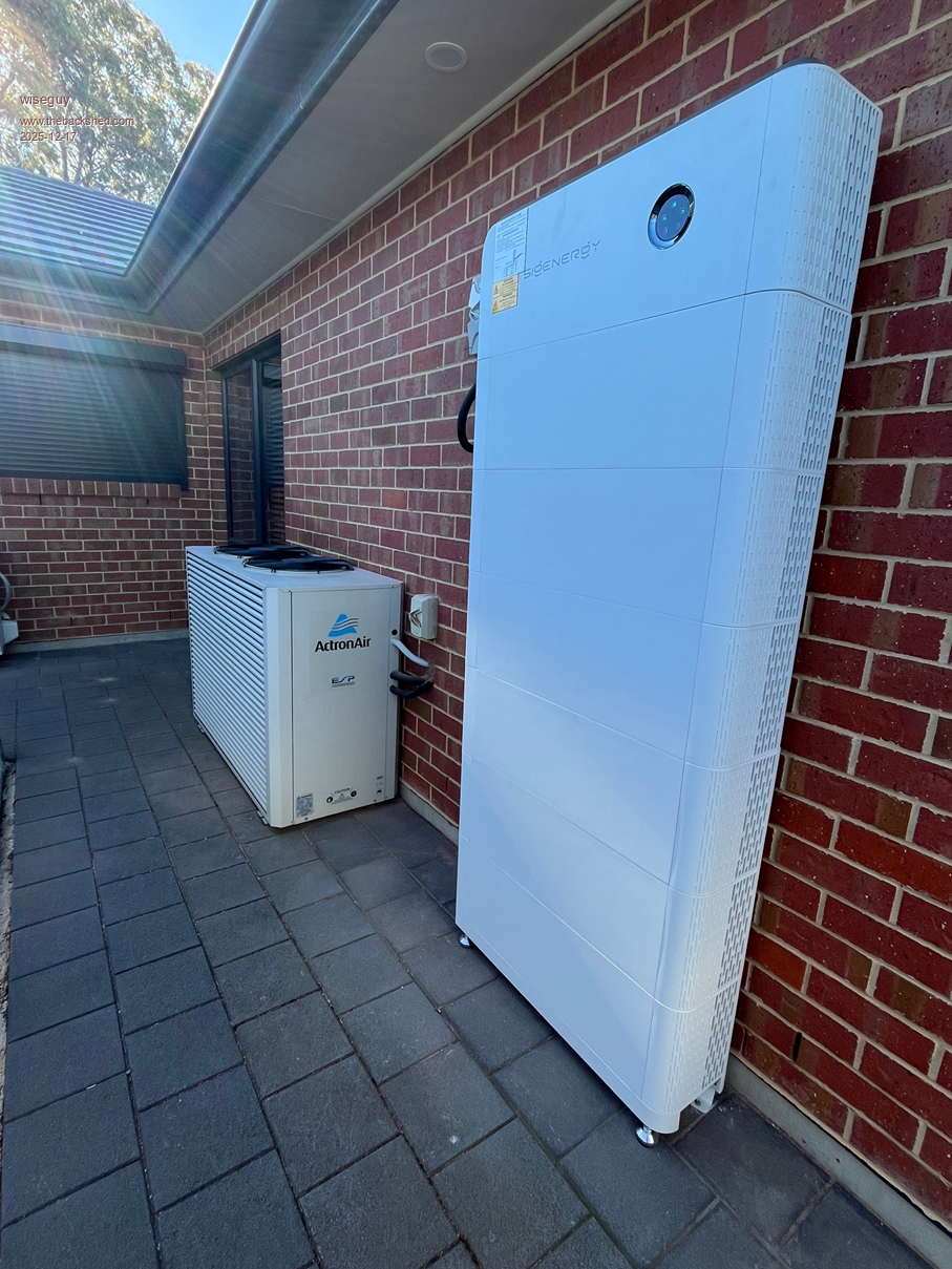

Posted: 06:51am 02 Dec 2025
It has been an interesting journey on the back shed to develop this inverter. I have been pondering the inverter situation and where to go from here. In my personal life I fully retired in May last year, I have a lot on my bucket list and a lot of it requires travel. Now that there are a number of my PCBs in use in various locations around the planet, I feel a need to support constructors present and future in a way that does not have to involve me where my ability to help etc may be hamstrung if I am away or unavailable.

The Sigenergy system went in today and was finished ~ 5.00pm. The batteries were only 40% charged and currently we are running our house including ducted air on the sig system. Now the air conditioning has ramped down to maintain temperature Power reduced from just over 7kW down to 2kW. The system now has 12.9kW (26%) remaining so in theory if nothing changes, we have ~ 6 hours remaining. However, as the evening cools, the air cant ramp down much further so it starts to cycle off for longer periods so I expect it to not actually draw from the mains tonight - we will see. Batteries should reach 100% for the first time by about noon tomorrow.
As far as pictures go there is very little to see. In the garage we have the Sig "gateway" which is a fancy name for wireless monitor of AC street info, AC from Sig and AC to the house.  It provides islanding from the street power when there is no power but otherwise it is ready to use street power to supplement our inverter/batteries if the Solar/batteries cant keep up with the load (greater than 25kW).
The rest is a stack of 6 x 8kWH modules topped off by the 25kW 3 phase inverter unit with 4 x MPPT's inbuilt.  The final picture shows the eaves / top of sig stack, should I put an angled metal shield, bolted to the wall, between the sig stack and the eaves to deflect heat and flames outwards past the eaves just in case??
Gateway unit:
Outside stack:
Edited 2025-12-17 20:27 by wiseguy
Cheers Mike
