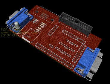

I am in the process of designing a CMM clone and would like to have a joystick connector on it.
Maybe 2 is even better.
I would suggest going for the standard 9 pin D connector.
The most important however is how to wire them up.
I guess Nick is the one with the most experience, what do you suggest Nick?
The goal would be to have a standard joystick connection so that anyone who writes a program for the CMM can use the same routines/PINS. This will greatly improve the playability of the CMM.
I would suggest using at least 2 analog capable pins per joystick port so that analog joysticks can be used too.
The same as some pins are designated to have extra functionality like com ports, i2c and CAN, designating PINS to use for joysticks would be a great thing.
If that is done we could ask Geoff to add joystick functionality to MM to make use of it even easier for the BASIC programmer.

At the moment i have this design in mind:
I don't have all the 3d parts yet so the render is incomplete, especially the VGA connector on the top left and the microsd front center. The idc should be a right angle.
