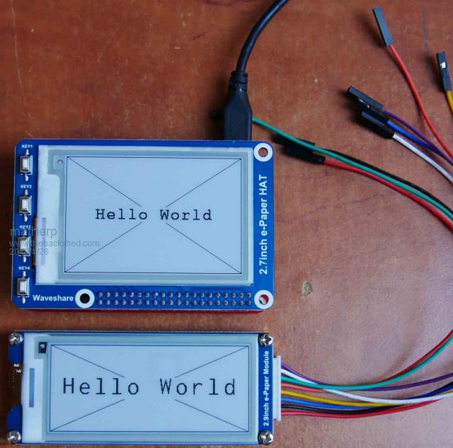

Attached are display drivers for the 2.7" and 2.9" E-ink displays.
These are written entirely in Basic using the new "User" driver capability in the latest release of the MM2, MM+ and MMX firmware.
The displays are S.....L.....O.....W
A screen refresh on the 2.9" display takes just less than 3 seconds and somewhat over 5 seconds on the 2.7" display (note this is not significantly affected by the Basic code - re-writing in C wouldn't help). Also the displays flash from a normal image to an inverted one and back to a normal one as they refresh.
but they are Very low power
As seen in the picture the 2.9" display is drawing 0 amps as it isn't connected.
When in circuit is draws about 0.7mA. I haven't measured the 2.7" display but I assume it is similar. The 2.7" display also has 4 switch inputs, useful for controlling an application.
The 2.7" display is mounted on one of my MM+ HAT stands (the red one). and the pinout in the code suits this layout but can be altered for any other layout. NB for the MM2 you also need to change SPI2 to SPI in the code (4 places)
Despite the adverts the displays are orientated in portrait mode:
176 x 264 for the 2.7" display
128 x 296 for the 2.9" display
I'm using the Rotated Text facility on the MM+ to print the text in Landscape (MM+ manual - page 27).
There a number of other E-ink displays available in various sizes and it should be easy to modify the code to suit (just look at the supplied Arduino "init" routine for the likely differences)

Edited by matherp 2018-01-27
Posts: 10147
Posted: 11:56pm 25 Jan 2018
Serious question: do you ever sleep?
Sleeping aside, these look very interesting. I wonder why they are so slow to update.
The likes of the Kindle pad etc can update the whole huge screen in a matter of a second or so. Not a complaint. Just curious as to why the wee ones you use here, can't update just as fast if it is really the same technology.
Azure
Joined: 09/11/2017
Posts: 446
Posted: 03:30am 26 Jan 2018
These look great. I saw there are even 4 colour versions (red, black, grey, white).
@Grogster
I just did a quick browse of the display specs and there are a lot (did I just say a LOT) of timing parameters that can be set to improve speed. The defaults appear to be set for best compatibility which is not the fastest.
palcal
Joined: 12/10/2011
Posts: 2061
Posted: 05:23am 01 Feb 2018
@ matherp
I have ordered one of the 2.9" displays for a project, I am trying to work out the
connections. In your code is 'const CE0 = 62' the CS pin.
Paul.
edit. Silly question, why CE0 and not just CEEdited by palcal 2018-02-02
Azure
Joined: 09/11/2017
Posts: 446
Posted: 07:43am 01 Feb 2018
The reference to CE0 is using the same documentation for the e-ink connecting to a RPi 3B.
e-Paper Raspberry Pi 3B
3.3V 3.3V
GND GND
DIN MOSI
CLK SCLK
CS CE0
DC 25
RST 17
BUSY 24
palcal
Joined: 12/10/2011
Posts: 2061
Posted: 08:37am 01 Feb 2018
Thanks for that.
Paul.
davematt
Joined: 27/09/2011
Posts: 55
Posted: 06:36am 05 Mar 2018
@ Matherp
I'm trying to drive a 2.13 in display (3 colours) with your 2.7in driver above. My unit has 104 x 212 pixels.
It appears to initialise, but stops at the drawline command , with "display not configured"
The option lcdpanel user, 104, 212 command says error, arguments.
Is there any info about the option user command available?
I would love to get this panel going because they have the priceless virtue of being readable using sunglasses!
TIA Dave.
Posts: 12265
Posted: 08:12am 05 Mar 2018
  Quote  Is there any info about the option user command available?
Which micromite, what version of the firmware?
davematt
Joined: 27/09/2011
Posts: 55
Posted: 10:16am 05 Mar 2018
Sorry, should have said.
28 pin pic 32 MX170 running version 5.04.08...
D
palcal
Joined: 12/10/2011
Posts: 2061
Posted: 02:11am 08 Mar 2018
My Display arrived today BUT my old box running Win XP that has been faithful to me for over 15 years has packed it in. Graphics card I think but is so old I will get another one, there is a computer recycler in town who is seeing what he can find for me.
Paul.
palcal
Joined: 12/10/2011
Posts: 2061
Posted: 01:15am 10 Mar 2018
@ Matherp
Finally got a chance to try my 2.9" E-Ink display using an E-28 Micromite. I get an error....
  Quote  [53] Dim S$(MM.VRes-1) length MM.HRes\8
Error: Dimensions
I tried using 'Option LCD USER, 128, 296' at the command prompt but get an error
'Argument Count'.

I used the following pins.
CLK = 25
DIN = 3
CS = 2
DC = 17
RST = 18
BUSY= 9
I changed the Constants to these pin nos. and changed the 4 instances of SPI2 to SPI.

Ok I have now loaded the file into an E-64 but now get an error...
  Quote  [297] i=SPI2(databyte)
Error: Not open
Paul.
Edit..
Thinking there maybe a problem with SPI2 I changed to SPI1 and it works OK.
I loaded it into the library, now how do I use it, do I have to delete the lines
  Quote  userdisplayinit(0)
line 0,0,mm.hres-1,mm.vres-1
line mm.hres-1,0,0,mm.vres-1
box 0,0,mm.hres,mm.vres
text mm.hres/2,mm.vres/2,"Hello World",CMU,5
refresh
end
Edited by palcal 2018-03-12
Posts: 12265
Posted: 08:27am 11 Mar 2018
  Quote  I loaded it into the library, now how do I use it, do I have to delete the lines
You need the line
userdisplayinit(0)
at the top of your program as this initialises the display.
Then just use exactly like any other display except that you need to call "refresh" when you want the display to be actually updated.

I have it working OK but it is much slower than you stated. Using this small piece of code,
timer=0
userdisplayinit(0)
text mm.hres/2,mm.vres/2,"Thanks Peter",CMU,5
refresh
print timer
It takes 18 seconds to display but the timer is only reading 2655 ?
Paul.
Edit.... Does the timer stop while the library code is executing?Edited by palcal 2018-03-13
