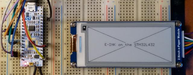

I've now included support for drawing functions and user mode display drivers
2018-11-09_022053_ArmmiteL4.zip
The example program uses the STM to switch power to the display so, as seen in the picture, the display is actually powered off - zero current usage - and the STM32 is sleeping @1.8uA. Based on using a normal 18650 LiFePo cell this should run like this for just over 100 years
2018-11-09_022827_epaper2.9.zip

Hi Peter. This is great and I want to build a battery powered device using this. I noticed you had an e ink display hooked up and I think this would be the perfect combination for a low power device. I want to add a smaller version (1.54") of the e ink display - HERE is the link for the one I want to use. Can you tell me if this smaller display would be useable with the armmite L4?
Thanks for this port, very impressive. Can't wait for my boards to arrive from digikey.Edited by viscomjim 2018-11-11
Posts: 12093
Posted: 02:59pm 09 Nov 2018
  Quote  Can you tell me if this smaller display would be useable with the armmite L4?
Yes, it would certainly work with a user driver like my example above but would need the initialisation sequence sorting out. I haven't got this size.
Remember though they are V..E..R..Y S..L..O..W
and you get artifacts as they update if that matters

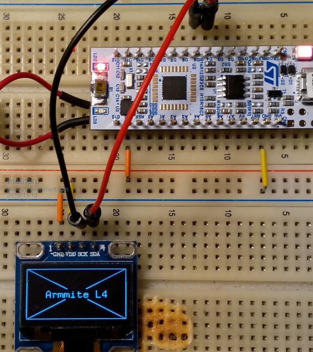

This version includes some new display drivers
2018-11-10_053808_ArmmiteL4.zip
Drivers supported are:
Nokia 5110 over SPI2
OPTION LCDPANEL N5110, orientation, DCpin, RSTpin, CEpin
and SSD1306 over I2C as in the picture
OPTION LCDPANEL SSD1306I2C, orientation [,Xoffset]
The optional parameter Xoffset is used to correct the display on 1.3" versions and should be set to 2 in this case.
You may also find that ILI9341, ST7735 and ILI9163 work as per the MM/MM+ over SPI2 but be warned these may be removed depending on space considerations as I implement more low power devices.
Edited by matherp 2018-11-11
