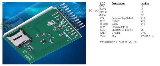

Hi again,
Well, my 1.8" displays arrived and I plugged one into breadboard connected to an LCD backpack with the 2.8" LCD removed. I edited ST7735-Driver.BAS to include "ST7735 16, 26, 187, 1" and loaded it into the mm, powered down then up etc. The connections are shown on the following picture of the card. I have not connected the pins for the SD card - is this a problem?
After trying most permutations for connections GUI TEST LCDPANEL seemed to work BUT:
- from the console CLS only cleared 40% of the screen (the other 60% stayed as the circles) (drawing a black box 128x160 clears the screen)
- any Text x, y , "Test" . . . wrote the text in landscape but as a mirror image. (not inverted but mirrored)
- I have played with the orientation options - all did as expected except everything was mirrored!
Any suggestions?
Cheers, Andrew
Posts: 12265
Posted: 09:51pm 26 Apr 2017
Try replacing the body of the CFunction with the attached. Sounds like your display isn't keeping up with the data rate so I've slowed it down. Could also be a lead length/crosstalk issue.
Also, get rid of the 47 ohm resistor

Andrew_G
Joined: 18/10/2016
Posts: 917
Posted: 11:48pm 26 Apr 2017
Sorry Peter but no change.
When it starts up ~40% of the screen is black (ie the section that CLS works on) and 60% is coloured snow.
Don't lose any sleep over it but a "Blinding Flash of the Obvious" (BFO) may occur sometime . . .
The resistor is gone!
Thanks for trying,
(you can't support every piece of kit on ebay)
Andrew

Posted: 11:07am 27 Apr 2017
Yes WW, Peter does a remarkable job!
More trials this morning:
- CLS only clears 40% of the screen within a program and on MM Edit's chat
- a Box with a fill overwrites the whole screen (within the box)
- the colours are scrambled, eg . . . rgb(yellow) gives cyan, red gives blue, green is OK, cyan gives yellow and blue gives red
- I have two of the LCDs and they each behave the same way.
Apart from being mirrored they are nice little displays - just what I needed for a GPS speedometer that fits in my car's instruments (a 2.8" touch is too big).
Cheers,
Andrew

Several steps forward but one hurdle still to jump - it won't Autostart (it requires the Console to be connected and a "Run" command).
Using the extremely useful program FontTweak by TassieJim I mirrored all my fonts (and set the location for Texting character by character). I now have it working and looking quite nice - and now on its own circuit, without the LCD Backpack.
But as I said above, it won't autostart.
I've tried:
- "Option Autostart On" in the program and/or from the console
- Changing the mm.startup line for the driver to be ST7735 16, 23, 18, 1 and changed the connections to suit (ie 23 instead of the original 26)
- Deleting the Library and trying again (but I haven't erased the chip or tried a new chip yet).
Any suggestions?
Andrew
(I had to smile when I realised that "WAIT" in normal font is "TIAW" in my mirrored font)

Andrew_G
Joined: 18/10/2016
Posts: 917
Posted: 11:42pm 28 Apr 2017
Thanks but sorry Bob and WW but it is not as simple as that (I wished it were).
I have actually been using "Option Autorun On" (but "mis-spoke" above - to quote a former US President).
I really do suspect my connections or, most likely, the compatibility of the device.
Cheers, Andrew

Andrew_G
Joined: 18/10/2016
Posts: 917
Posted: 11:55am 29 Apr 2017
Many thanks WW (et Al)
  Quote  Unless the PIC is corrupt in some way
There were no error messages etc so I decided to try a new chip (loaded the firmware, Peter M's original driver etc). It worked right away with no mirrored font and no split screen! Only problem was that the flipped fonts I created were now flipped.
I've gone back to normal fonts so all should be good with Peter's driver perfect!
In summary - a corrupt chip!
(In the process I have cooked a SMD resistor on my console connector so I will be grounded till I can get a new one - too much smoke escaped so it stopped working - even turned my PC off)
Many thanks to all, Andrew.Edited by Andrew_G 2017-04-30
