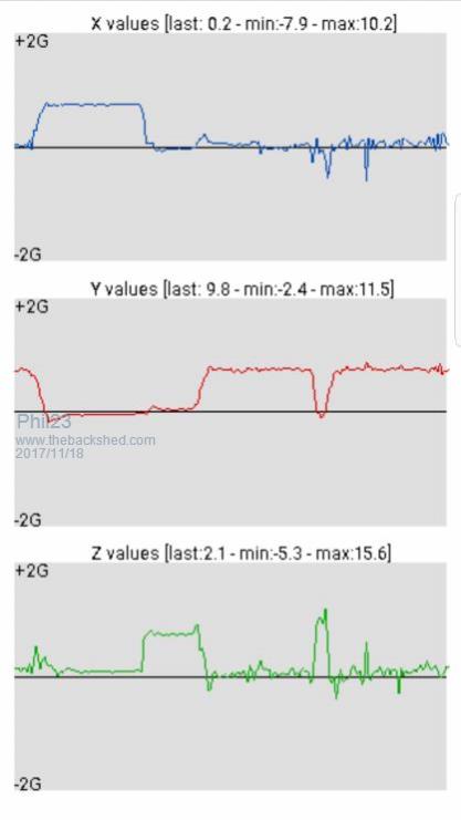

Posted: 12:21am 18 Nov 2017
One I had loaded outputs G's in each axis,
Moved my phone around a bit & got this.
Cheers.
Edit,
Graph spans maybe 30 seconds.Edited by Phil23 2017-11-19

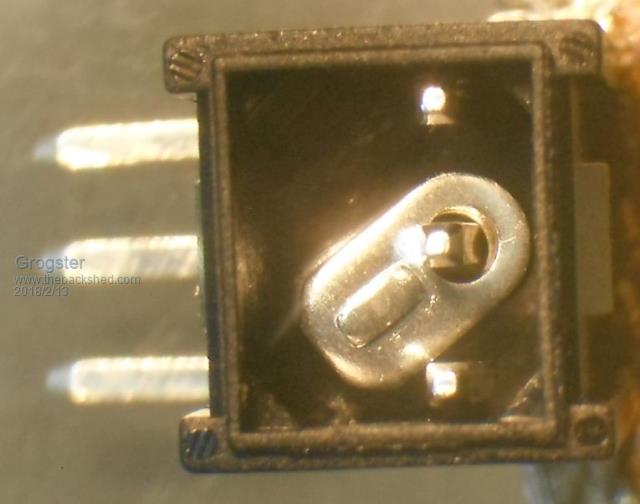

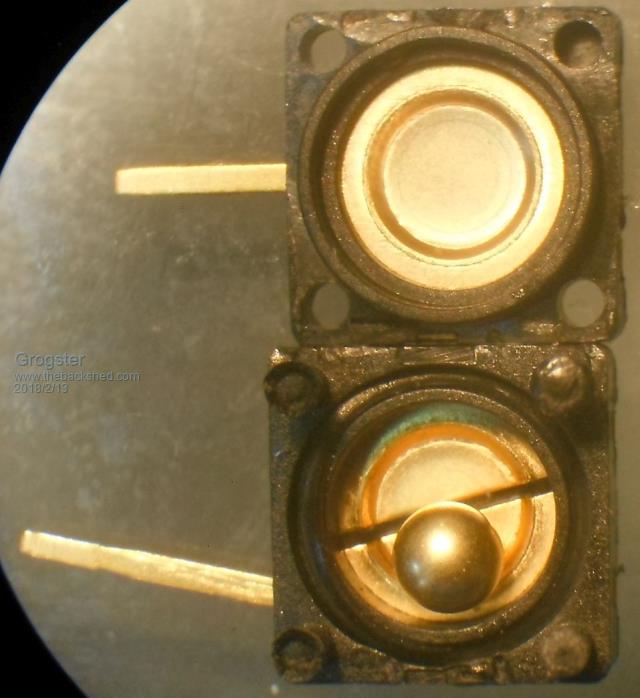

My new sensors from Digi-Key have arrived.
The first one is a left-right tilt switch in a single package. Here is a photo of it's guts:
This one is pendulum based, and there are actually three little pendulums inside there, stacked one on top of the other. I will hook up one later and test it out.
The next one is another ball-switch unit, but it is indeed gold-plated. Here is a photo of it's guts:
The gold-plated one will probably give the least trouble cos of the gold-plated contacts, ball and retaining cup. I will hook both of them up and have a play later tonight. As these ones are from a more reputable supplier, I hope to have less isses then I was having with the ones from China. Well, the ones from DigiKey are still made in China anyway, but I guess there is more quality control.
