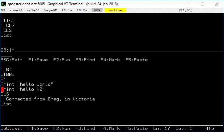

| greybeard Senior Member Joined: 04/01/2010 Location: AustraliaPosts: 181 |
ok, could telnet and this is what we see. ![]() |
Grogster![]() Admin Group Joined: 31/12/2012 Location: New ZealandPosts: 9975 |
Marvellous! ![]() I will leave this on-line for a few more hours. If anyone else wants to try and let me know, please do. Smoke makes things work. When the smoke gets out, it stops! |
