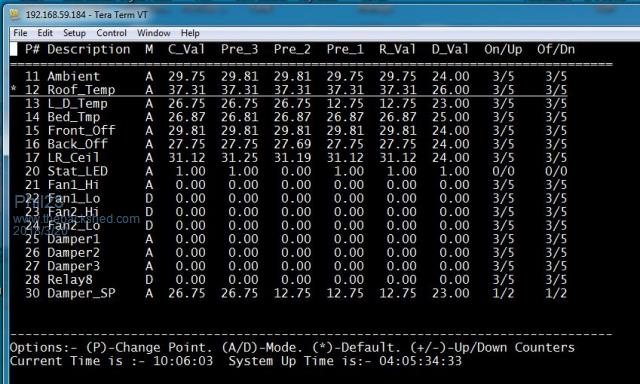

Dear folks! I see it's been almost four years since I last posted.
First an update on the MM powered Wood-Fired Boiler. It has been running flawlessly now for over six years. Yahoo Maximite! I'm getting older though and find spending summers collecting 12 cords of firewood more than I want to do for the rest of my life. So this past summer (June-July 2017) I built an electric boiler. It too is run by the MM and I modified the software just a bit so it could do both the electric and wood-fired boiler.
I am just finishing up a winter test of the electric boiler, and it also worked just fine being run by a MM. Now I'm setting out to build a dedicated MM for it with a control board and three temperature sensors and a 12 volt battery sensor, two relays too. I want a control panel in the house so the time periods and house thermostat temperature can be adjusted indoors, unlike the wood-fired which was controlled out at the firebox.
So here is my question. I built a MM with a component board, numeric keypad and a small 5" monitor. I have written most of the software that relates to the three temperature sensor/voltages: House, Outdoor and Boiler temp. I used 1.8 K Ohm resistors for the House and Outdoor, and a voltage divider for the Boiler water temp (so it will read up to and slightly above 100 c (this is not a pressurized system). What I'm finding is that I get fluctuating voltages from the three sensors. They vary more than I want. The outdoor sensor fluctuates between -5C and -8C all within one minute. This seems a bit much.
I created an averaging loop that collects sensor readings every 50 loops (8 seconds), and then different numbers of those loops for sensor averaging depending on how many data points I want to average for each. The outdoor sensor is set for 5 or (50 loops x 5 or 250 program loops) or about 40 seconds. Even so, I'm still getting more fluctuation in the LM355 sensor loops that I want. I'm averaging the House sensor 2 (50 loops x 2 or 100 program loops) or about 16 seconds. Similar with the Boiler temp average.
As some of you may recall, I'm no electronics guy. I have pin boards and a good collection of components, but I really don't know how to tackle this. Is there some way that using components I can even out the voltage on each of the LM335 Temp sensor circuits? Would a capacitor accomplish this? Seems like there must be a better way than attacking this problem via software. If a capacitor would work, what rating would I need, and where would it be wired on? On the two simple 1.8 K Ohm sensor circuits, these are so simple that I might be able to figure that out without a schematic.
Am I thinking in the right direction? I don't recall having such fluctuations in the wood-fired boiler sensors, which are also three, one being on a voltage divider for the higher temperature boiler water and the other two 1.8 K Ohms. I do have temperature averaging routines on it too, but I don't recall ever seeing fluctuations this large in such short periods of time.
So, is there some way that I can even out the voltages in these LM335 temp sensor circuits so they don't bounce around so much?
Any thoughts are welcome. Thank you for all the help in the past. My first project back in 2011/12 turned out really well. I think this one will too.

You are right the LM335 shouldn't vary that fast. It's internals don't respond that quickly even with a rapid change in the environment.
Check your supply voltages, both 5V and 3.3V for any fluctuations.
Consider changing to the DS18B20 temperature sensor.

The LM335 is both reliable and stable.
This is more or less an "Old School" device that outputs temperature in degrees K, or Kelvin. 10mV/°K.
373°K = 100°C = 212°F = 3.73V
330°K = 57°C = 135°F = 3.30V
271°K = 0°C = 32°F = 2.73V
I suspect you are reading this voltage using an analog voltage pin which has a voltage range of 0V to 3.3V.
The highest reading you can do is 57°C.
Unless there is additional circuitry, say a voltage divider or Op-Amp, you will not be able to read higher temperatures.
I usually add a 1uF capacitor directly cross the LM335 and another at the analog pin.
Use a twisted pair out to the sensor.
And a pullup resistor, probably 2K or so, to 5V at the micro end.
Even better, if needed, use shielded twisted pair wire and ground the shield at the micro.
The Digital temperature sensors such as the DS18B20 have built in code on the MicroMite. However, I don't know it ver 3.0 has this.

Yes I'm running these sensors on analogue 3.3 volt Maximite pins. I'm using speaker wire to run to the LM335's. They are not shielded but I live far out in the woods and there are no radio or TV signals here to give you an idea how pristine our electrical wavelength environment is. I will try putting caps across the sensors and the MM pins and report back.
I used 1.8 K for the two sensors for House and Outdoor, and a voltage divider for the Boiler temp sensor. I'll try 1uF caps on all of these and see if that helps.
Thank you!

I put a 1uF cap on the breadboard where the sensor wire and the Maximite pin jumpers both connect. Still showed a variation of 4C within two minutes. This is not accurate, my other temp sensors outdoors (on another MM) show no such fluctuations beyond one degree, and that would be probably when the temp actually changes.
I wonder if I should be putting the cap right out at the end of the wire with the LM335 instead of at the breadboard?
I don't have any shielded twisted pair wire but I can order some. What size would be good for this. I would like wire lengths of up to 50' on two of the sensors. Does shielded 22 gauge sound large enough for a 50' run at about 3 volts?

I reread your original post. And see you said you have a voltage divider for the 100°C sensor. In addition to the 1.8KΩ pullup what are the divider values?
What is this divider made with?
Note! The pullup must go to +5V.
I like using 1uF but 0.1uF would also work well, I presume.
This capacitor should be a ceramic type as they have very low leakage currents.
This capacitor provides the low impedance needed by the analog input. The impedance spec is a max of about 5KΩ. Since the measurement takes about 200nS which has an impedance of about:

The internal voltage divider, in the AtoD converter, is connected between Vcc and Gnd. Any noise on Vcc will show up in the reading. A good way to compensate for this is to divide the capacitor between Vcc and Gnd.
In your case, where one capacitor is placed across the remote sensor, the second capacitor should be placed across the 1.8KΩ pullup.
On the 100°C sensor a pair of 10KΩ voltage divider resistors can be connected to the analog input. The pair of 10KΩs look like 5KΩ to the input.

I have the house sensor on the computer bench pinned to the breadboard in the back room. It has only a 1 foot wire from the breadboard and lays on a marble table insert for soldering so temp there doesn't fluctuate much. No wind either. In the past three minutes I saw readings of 12, 13, 14, 15 & 16 C. I know this is not correct. My project screen displays F, but before I came back to this group I added small displays of C so we could communicate easier. I think I'll keep both F & C on the display as it is informative. Anyway, I don't think such a short sensor wire would have EMF effect that might cause that much fluctuation. I worked on trying to resolve this over a week before coming back to the group for help. Can't say I don't try!
Anyhow, I'm still stumped.
Regarding the Cap I used, It is a can cap.
The voltage divider sensor circuit is the least important. It is reading the electric boiler temp but is informational only at this time. It is reading 52 C right now, below 52 it will turn off a fan allowing the boiler temp to rebuild. I don't have this relay built yet. The high temp each day for this boiler water temp circuit is about 90C most nights when the house thermostat is turned back. The old Wood-fired boiler/MM is still handling fan control even though the water is being heated by electricity today. It probably fluctuates too, but a fluctuation of four or five degrees in the boiler is something I can't discern.
It will be the House temp sensor that will control the fan when this stand-alone unit is finished. That is why I need a fairly reliable and non-fluctuating House temp circuit. I only display period high and low temps for Outdoor temps. That is how I noticed the fluctuations so readily on a new boot. I get fluctuations in both house and outdoor temps of as much as 5 C in the first two or three minutes.
