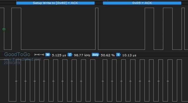

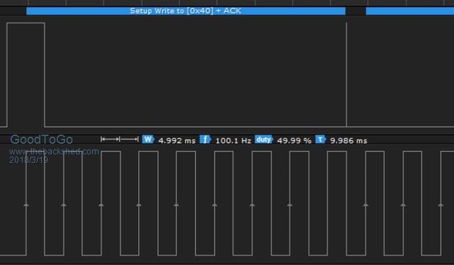

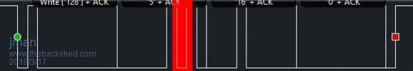

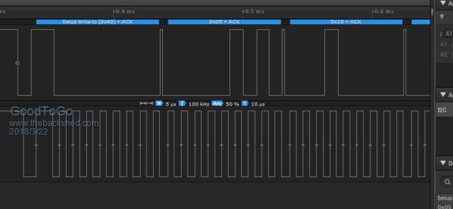

Screenshots of the write and we can see the timing is not the same.
The working write is below the bit in RED is 10.1us
The NON working write the bit in RED is 9.988ms
Export of the trace in txt format, seems odd the reads are missing from the NON working one
Working

Not Working
Time [s],Packet ID,Address,Data,Read/Write,ACK/NAK
0.902392583333333,0,'128','5',Write,ACK
0.992295416666667,0,'128','16',Write,ACK
1.08219,0,'128','0',Write,ACK
1.30808975,1,'128','0',Write,ACK
1.39799591666667,1,'128',<,Write,ACK
1.48789825,1,'128','207',Write,ACK
1.70038208333333,2,'128','4',Write,ACK
So it seems the timming is an issue

The screenshots don't help - I presume that the red patch is the transfer but it is unreadable.
The difference in "the trace in txt format" is that that the two reads at the end are missing. Otherwise the listings are identical.
We need some correlation between what your program was doing and the trace. Can you modify your program to print the arguments to every write and read? Comparing that to the trace might shed some light on the issue.

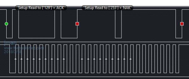

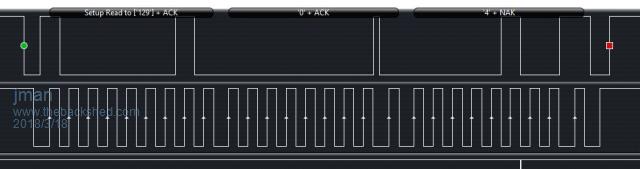

Some more info from the logic analyzer
Working read
Non working read
Working export

Not the non working one has NO ack after the setup to read but instead has a second setup to read ?

Finally got around to trying this on my logic analyser. (Saleae knock off)
The first thing I noticed is that the I2c clock for the MM port is 100KHz. However the CFunction appears to be 100Hz!
Using the dedicated I2C port:-
Using the Cfunction:-
Attached are the analyser files (in LOGICDATA format) for anyone to have a look at.
2018-03-19_154535_I2C_INA219_Logicdata_files.zip
The clockspeed explains why it's slow I guess......
Thoughts?
