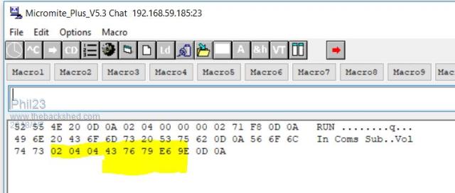

Next step in the phase,
I'm now sending 02 04 00 00 00 02 71 F8 with this:-
  Quote   volts$ = CHR$(02)+CHR$(04)+CHR$(0)+CHR$(0)+CHR$(0)+CHR$(02)+CHR$(&h71)+CHR$(&hF8)
Dim String DataStr
print volts$
Open "Com1:9600,,RecComs,8" as #1
print #1, volts$;
Pause 100
Sub RecComs
print "In Coms Sub"
Local Integer HdrLoc,FtrLoc,BufLen
'Local String DataStr
If LOC(#1)>8 then 'If COM1 serial port buffer is NOT empty.... Was 100
Do WHILE BufLen<> LOC(#1)
BufLen=
LOC(#1)
Pause 50
End If
DataStr=
INPUT$(LOC(#1),#1) 'then suck everything in the buffer out and stick it in D$....
print "Volts";DataStr
'IEEE754
End Sub
The meter is returning this in the highlight.
Ignoring the CRC at the moment, I a bit vague on how I extract the value to be converted to the float, as the returned string is unprintable hex values & I only need a portion of it.
Phil23
Joined: 27/03/2016
Posts: 1667
Posted: 03:46am 07 Apr 2018
Data returned doesn't look right either.
The 43 76 79 E6 is 246.48 Volts which is about right,
but it looks like there is only 1 CRC byte. 9E.
Phil.

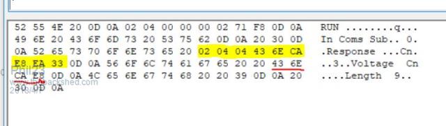

Phil23
Joined: 27/03/2016
Posts: 1667
Posted: 04:39am 07 Apr 2018
This looks better with 9 bytes returned, I can see the voltage before the the 2 byte check sum, but can't see how I turn it into a series of hex numbers as it's sort of that way already in the string. Just not readable hex.
Phil.Edited by Phil23 2018-04-08

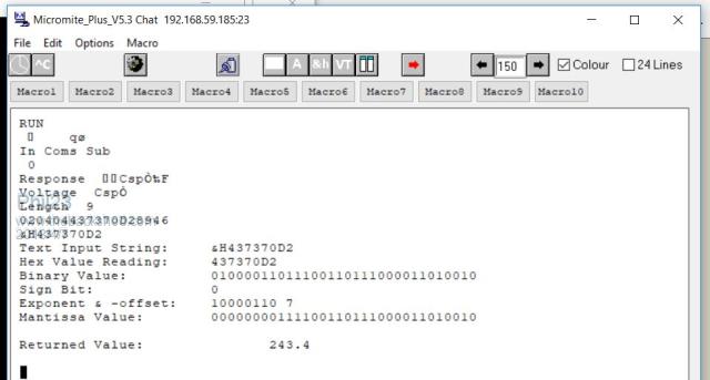

Phil23
Joined: 27/03/2016
Posts: 1667
Posted: 05:45am 07 Apr 2018
Ok,
I now have this mess of workings and it is returning a result.
Just not sure if I'm going around in circles converting data from one form to another un-necessarily.
Any feedback would be greatly appreciated.

Bit I have trouble getting my head around is that the "String" that comes in the com port is really a series of bytes & how I should treat them.
Phil.

PS, I am now successfully reading the first Six registers with a single request & converting them successfully.
They all reside in the address range from 30001 to 30032.
