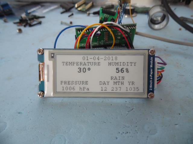

Got it working. I am using an old HH10D humidity sensor all my DHT22 sensors don't work. I have had about 6 of them and they all fail. I guess I should buy genuine but how do you know. The rain figures are fake, I have a problem with the reed switch in the sender not switching properly so have to wait for a new one.

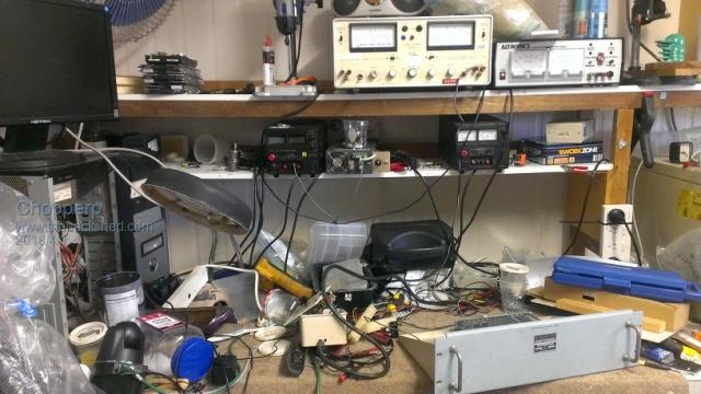

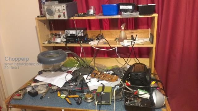

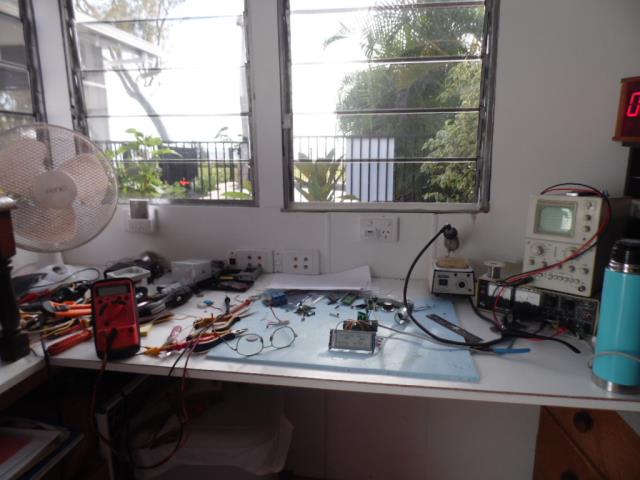

Looks good Paul.
Nice to see some clear space on a work bench as well :-). I have a hard time keeping free space for doing stuff on any of mine.

Like this.

2 of my benches at the present time. Do a lot of dumping on them. Yours is good.

Yes, I am happy with the display and it can be seen in sunlight but really only good for something that only needs updating occasionally.
