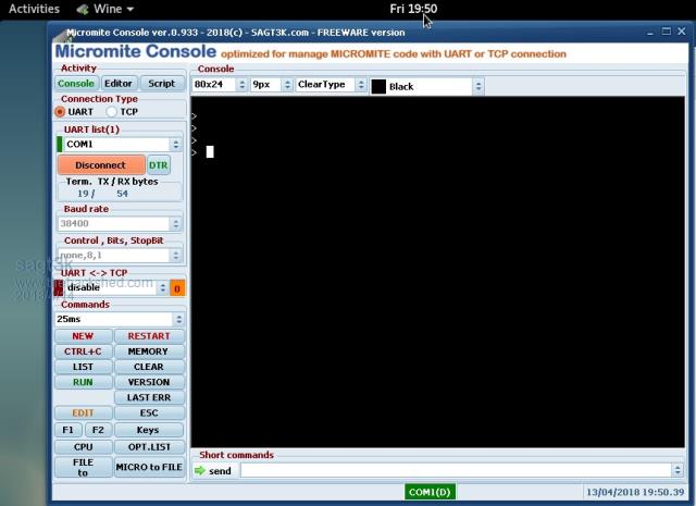

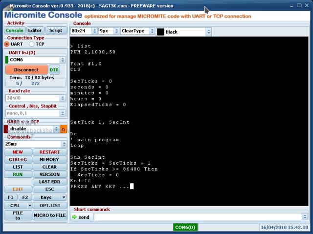

sagt3k![]() Guru Joined: 01/02/2015 Location: ItalyPosts: 313 |

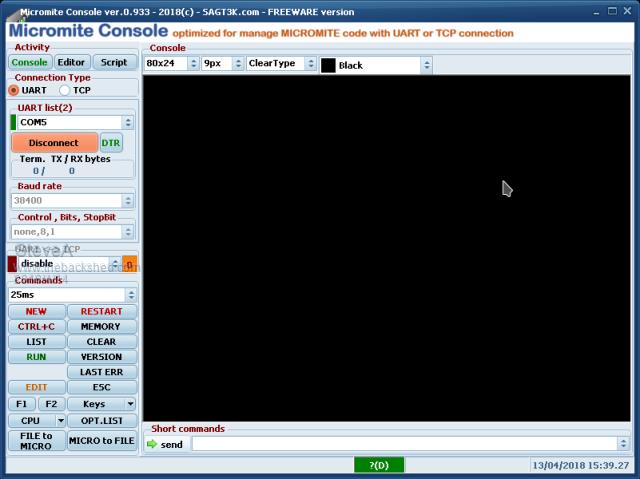

Hi SteveA Here you can find MicromiteCons v.0.933 which is optimized to work with wine. To make sure you can add a COM on Linux platform port just double click in the "UART LIST (0)" section and add a number. For example digit only 7 to add in list COM7. Here you can find discussion on MicromiteCons. Thanks Antonio |

Hello Antonio, I had the the time to try your program, it runs, but unfortunately it doesn't detect any of the UARTS on my Chromebook, the drop down list is empty. GtkTerm (Linux) and MMedit (Windows) both list all the available ports and allow me to select one. It works on my Windows machine, so I'll have a play with it on that instead. Steve Added: I,ve reread your post and had another quick play. I can double click and assign a port number, then when I click connect the program thinks its connected, buts it's not! In the terminal window I get the following:- fixme:ntdll:server_ioctl_file Unsupported ioctl 1b0048 (device=1b access=0 func=12 method=0 fixme:comm:set_queue_size insize 4096 outsize 4096 unimplemented stub |

Hi SteveA Generally COM (only on Windows) are recognized by extracting from the list of "COMx" strings. I read the list from regedit "HLM\hardware\devicemap\serialcomm" What kind of UART HW/USB are you using? Thanks Antonio |
Hi SteveA I try on Devian with a VMachine. My system see MicromitePlus connected by USB as "ttyACM0". Then in Linux I try with "ln -s /dev/ttyACM0 ~/.wine/dosdevices/com7". Then start "wine MicromiteCons.exe" , add COM1 and I connected with console. Antonio |

I did exactly the same and gtkTerm and MM edit can connect to the MM. This is the bit that doesn't work, the program runs but the dropdown list isn't populated and although I can add a port it doesn't connect. There is obviously something very obscure going on between wine/ubuntu/chromeOS! I'm not a Linux expert, and I don't think I'll get to the bottom of it, so I'll carry on using MM edit. Thanks for your help. Steve |
