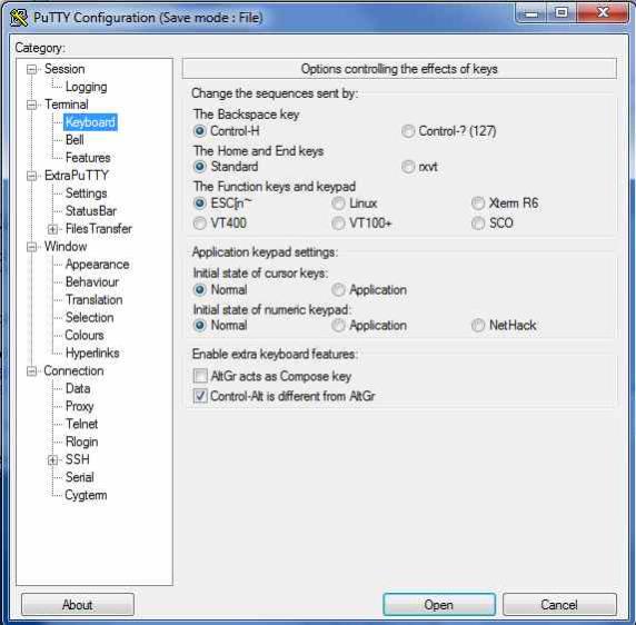

  CaptainBoing said  My dev' cycle might seem a little convoluted but it works really well for me: everything is written and maintained in the editor (Notepad++) Ctrl-A, Ctrl-C, F10 on the Mite (via putty or USB Terminal), a right click to paste everything, Ctrl-Z and that is it. It is a fast cycle and I reduce field reliance to an editor and a terminal prog.
Can you explain this in a little more detail--in particular, the setup of putty and how the F10 key works--I read that it stands for AUTOSAVE, but when at the ">" prompt, if I hit F10, "OY" is printed. Right click then stalled after a few lines.
CaptainBoing
Joined: 07/09/2016
Posts: 2171
Posted: 06:38am 11 Oct 2018
here you go, I exported by workbench session for you. If you pop the attached file in
C:\Program Files\ExtraPuTTY\Bin\Sessions (or whereever you store your putty sessions) you'll have all
the settings I use
2018-10-11_163839_lizby.zip
