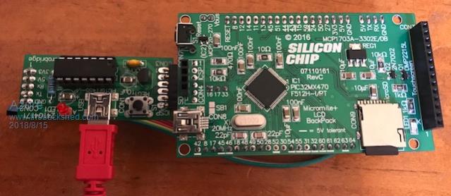

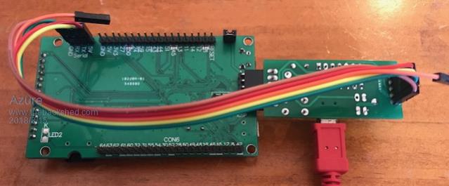

I now program my MM Plus 64 LCD Backpack and talk to the console using the microbridge.
The notebook I use has a 4K screen and the Microchip IDE/IPE just did not like it (it is a little better now but not great). That started me looking for other ways to update the firmware so I gave the microbridge a try.
Get yourself a microbridge kit. I have a genuine pickit-3 and also pickit-4 and the microbridge.
The microbridge with both serial (with your choise of comms software) and icsp port using pic32prog is much easier. You can keep the comms window open, just disconnect (in the comms software), press the mode button on the microbridge and run pic32prog, when it is finished just go back to your comms software and reconnect. No cables to change or usb disconnect/connect issues, one nice little convenient module does both.
If you are using the MM LCD Backpack V2 it has the microbridge build into the Backpack. So same toolset just need to load different firmware file depending on which you are working with.
Here is a picture of it connected up for both ICSP and Console (front and back).

In my pic that little board is the Microbridge plugged into a SC MM Plus 64 BP. It has an ISCP for programming and another connector (that I put the jumpers on) to connect to the console. Doing that there is no USB plug change or wires to change to go from programming to talking to the console. you just do a software disconnect and reconnect in your terminal package while you use the programming software.
