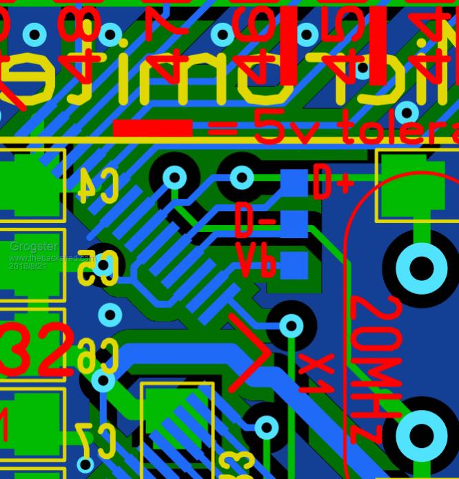

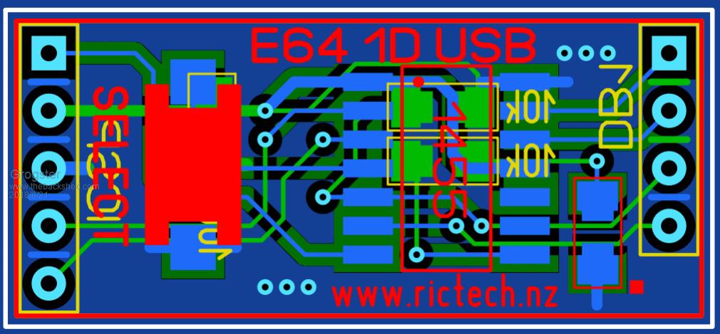

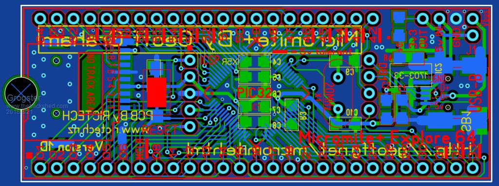

Posts: 9975
Posted: 11:34pm 20 Aug 2018
Well, WW might have had something there.....
First image is of the modified E64, still two-layer.
Bottom image is of a small daughter-board that plugs into the the pin-headers on the E64, to provide all the 1455 features.
Naturally, the E64's USB socket has now been routed to the daughter-board, and is no longer connected to the PIC32 chip.
Daughter-board size is 31mm x 14mm, so quite small. 1455 chip is standard SOIC. All passives are still 1206 size on both the E64 and the daughter-board.
The 1455 daughter-board plugs into the two pin-headers on the E64. One of them is the existing ICSP header, and the other one is just to the left of the USB socket. The board is self-supporting on the pin-headers.Edited by Grogster 2018-08-22
Posts: 6538
Posted: 12:16am 21 Aug 2018
Looking good Grogster.
I reckon I could retrofit one of the daughter boards to my 1B board.
The USB data lines are get-at-able on the 1B, even for me.
I assume the other two pins at the front go to the console pins.
Posts: 9975
Posted: 12:22am 21 Aug 2018
You assume correct.
Posts: 2991
Posted: 12:25am 21 Aug 2018
Hi G,
This looks good.
So the E64 can be powered via the 'existing' E64 USB socket. And then when you want Comms and/or Firmware update you just need to insert the daughterboard (and fire up TT or PIC32PROG). Is that correct?
Would be great to test this out to see how it 'feels' in operation. Then if its ok (and after any 'tweaking') this could possibly be a standard 'comms/programming' module used for any future MM board designs.
Great work G . . .
Posts: 9975
Posted: 12:33am 21 Aug 2018
Hey there WW.
Yes, if you install the daughter-board, you will get the 1455 USB serial connection, and it's HEX programming features. Without the daughter-board, the E64's USB socket becomes a power-only connector.
This will totally avoid all the problems with the E64's current PIC32/Microchip USB connection problems when users press the E64's RESET button.(which causes Bill to drop the VCP)
Posts: 6538
Posted: 01:43am 21 Aug 2018
If you were really adventurous, you could put three solder bridges for the 3 traces you removed to pins 34, 36 and 37 so that any masochists out there could still use the old USB.
Why anyone would want to, I am not sure.
Posts: 9975
Posted: 01:52am 21 Aug 2018
Why not.
There is space there for some very small pads now. As you say, weather anyone would ever use them....
