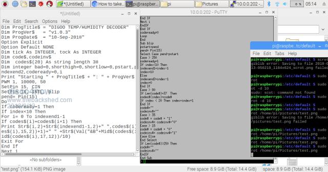

What I am wanting to achieve (within Raspbian on a RPi) is to copy code from a .BAS file (which I can open in Text Editor) and Paste it into the MM Editor screen which is displayed in PuTTY (liken this to TeraTerm on a Windows machine). I also want to do the reverse, i.e. copy code from the MM (PuTTY) and paste it into 'Text Editor'. So I have successfully installed PuTTY on a RPi (latest version of Raspbian GUI) and connected up a MM which can be seen/controlled. BUT I just cannot find a way to copy 'text' between PuTTY and the Text Editor. If anyone out there has the full version of Raspbian installed on their RPi, please can you try and help me! To install PuTTY I simply followed these three steps: 1> sudo apt-get update 2> sudo apt-get upgrade 3> sudo apt-get install putty -y I then hooked up a MicroMite and opened a 'link' to it. All is good at this point. ![]() I can copy some text from the built in Text Editor (under the 'Accessories' tab) and Paste it back into Text Editor (confirming it is on the 'clipboard'). However, I just cannot Paste it into PuTTY. For reference, PuTTY installed on a Windows machine does work - default is Right-Click mouse, and the clipboard is pasted into the current cursor position. (This can be adjusted within PuTTY settings to make a Menu appear on Right-Click, to then allow selecting 'Paste' from the subsequent drop-down list). RPi PuTTY has Ctrl+Right-Click to bring up a Menu, from which there is a 'Copy All' option. Upon selecting this, I cannot Paste 'it' into either PuTTY or into Text Editor. Please can someone help! NOTE: I am needing to use PuTTY rather than another 'app' UNLESS anyone can get either MMEDIT or GFXTERM running on a RPi . . . . |

Thanks Gerry. I have just had partial success with Shift + Ins (paste) and Ctrl+Shift (copy). However, it is only pasting in one line (from Text Editor) when I am in the MM's Editor screen (i.e. F4). BUT when in the Command Prompt, it Pastes ALL the lines? |
| WhiteWizzard Guru Joined: 05/04/2013 Location: United KingdomPosts: 2991 |
Looks like how I copy text from Text Editor (TE) has different results upon pasting into PuTTY. Using Ctrl-C (within TE) will paste only the first line from the clipboard into MM's Editor Using Right-Click and then selecting 'Copy' will take the first line (excluding the last character from the first line) and the second line (excluding the first character from the second line) and make then one line in MM's Editor. It ignores any more lines from the clipboard. So possibly a CR LF issue in both PuTTY and TE. Will continue to experiment . . . . |

@CaptainBoing On RPi PuTTY, currently the Right-Click simply draws a white highlighted line at the point of the mouse cursor. Nothing appears at the text cursor, and nothing seems to be on the clipboard when LeftClick dragging. Ctrl-C from another app and then Right-Click in PuTTY does nothing either (apart from white highlighted line at cursor position). Is there a Mouse setting somewhere 'deep' in a system file that possibly needs to be modified? (as there is nothing in the PuTTY options) |

Thanks CaptainBoing The closest success I have is Ctrl-INS to copy, and Shift-INS to paste. However, in the MM Editors screen (F4 from command prompt), I only get one line inserted. Not sure if Geoff is doing some logic at the CR/LF stage which then prevents the other lines being inserted. This is all part of a new 'TermMite' project I am working on; so to be able to solve this will open up a nice feature for controlling a building full of 'remote' MMs |

@CaptainBoing, anyone The Paste into PuTTY worked as needed; i.e. F10 at command prompt (AUTOSAVE), Shift-Ins (paste), Ctrl-Z (terminate). Now to find a way to 'reverse' this from the micromite EDITor back into Text Editor. You'd think that Copy from EDITor, and Paste would work but it doesn't! It is as if the PuTTY clipboard is independent of the RPi generic clipboard.I use Ctrl-Ins within PuTTY to put on clipboard (and can confirm it is there by pasting itself (Shift-Ins) back into PuTTY, but using Paste in Text Editor does not work (it just pastes whatever is in the RPi generic clipboard). What I thought would be such an easy thing is turning out really tricky. At least CaptainBoing got me half way there. Anyone out there with any ideas ? . . . |
