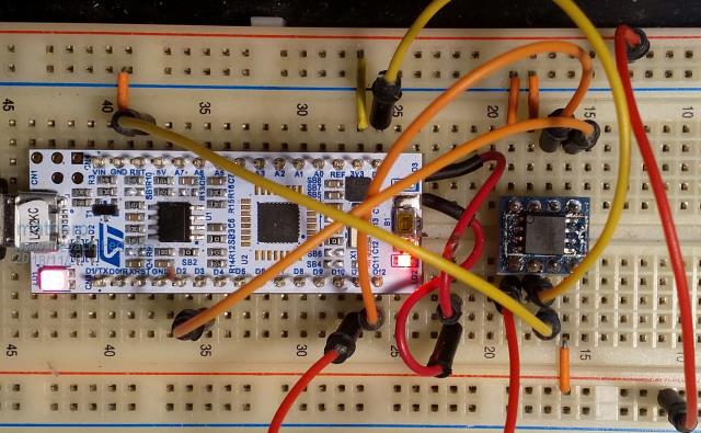

Wiring of the SPI flash is as follows:
Pin 1 : Chip select, connect to any free pin on the uP
Pin 2 : SPI data out, connect to SPI2-IN (D12) on the uP
Pin 3 : _Write enable, connect to GND
pin 4 : GND, connect to GND
pin 5 : SPI data in, connect to SPI2-OUT (D11) on the uP
pin 6 : SPI clock, connect to SPI2-CLK (D13) on the uP
pin 7 : RESET, connect to RST on the uP
pin 8 : VCC, connect to 3.3V
To enable the flash memory use the command:
OPTION FLASH CSpin
CSpin can be specified as the pin number or the pin ID (e.g. D3)

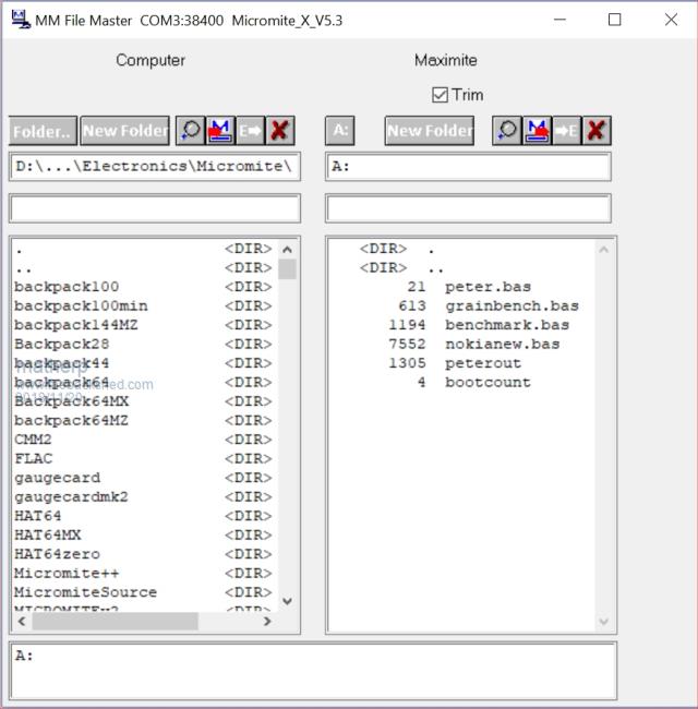

The MMEDIT filemanger is fully functional
The system will create and maintain a file "bootcount" on the flash memory. This keeps a count of the number of times the uP is restarted and can be interrogated with the function MM.BOOTCOUNT. The file can be deleted but will be re-created on next reboot.

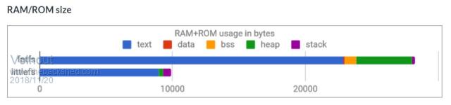

this is a major advancement roughly, what is the flash footprint of adding LittleFS support? is it something that could be back-ported to the MX170-based micromites, even if just as a c-function stashed away in the library?

Even if it eats 10k of RAM/ROM it would so much enhance these smaller micromites.
This would even make it worth designing a new 170 backpack PCB, just to incorporate the winbond chip. Needs only 1 pin extra since SPI is already shared with display and touch.

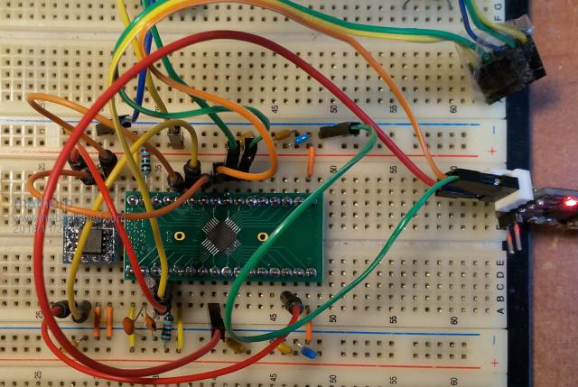

Received some chips and breakout boards from Farnell this morning so all up and running without the ST-LINK. Minor update needed to support the now-tested 128Mbit Flash chips.
2018-11-21_025725_ArmmiteL4.zip

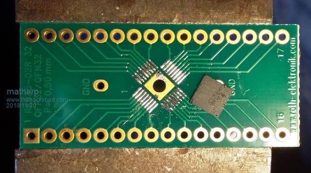

To solder it wasn't a problem, I tinned the connection on the breakout and applied lots of flux as in the first picture. Then I located the chip and applied the heatgun until the solder melted. The chip sat down nicely into the solder and all the pins checked out.
Required connections were:
Pin 1 - 3.3V
Pin 2 - 32KHz Xtal with 4.7pf cap to GND
Pin 3 - 32KHz Xtal with 4.7pf cap to GND
Pin 4 - 10K pullup to 3.3V
Pin 5 - 3.3V
Pin 8 - USB/UART RX
Pin 16 - GND
Pin 17 - 3.3V
Pin 25 - USB/UART TX
Pin 31 - 10K to GND
Pin 32 - GND
I used 0.01uF, 0.1uf, and 2.2uF decoupling on both rails

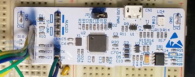

The taped together connection is for the ST-LINK programmer from a full-size Nucleo used to program the chip
Pins are:
ST-LINK Pin 1 - 3.3V
ST-LINK Pin 2 - uP Pin 23
ST-LINK Pin 3 - GND
ST-LINK Pin 4 - uP Pin 24
ST-LINK Pin 5 - uP Pin 4
NB: the STM32L4 doesn't need any sort of VCAP just sensible power de-coupling

matherp, this is getting pretty neat! To program the chip without it being on a development board, would you use something like THIS ?
Is the method of dragging and dropping the .bin file only supported with the extra parts on the development board that allow this method?
All pretty new to me, so sorry for the noob questions.
Posts: 11499
Posted: 07:06pm 20 Nov 2018
  Quote  would you use something like THIS ?
Should be OK. I just use the top part of a Nucleo PCB which I broke off from one I killed. Also has the advantage it provides a USB/UART.
  Quote  Is the method of dragging and dropping the .bin file only supported with the extra parts on the development board that allow this method?
No, this is a function of the ST-LINK processor. The question mark over a clone is whether this is properly implemented and up-to-date. Certainly the one you linked doesn't support the USB/UART functionality
