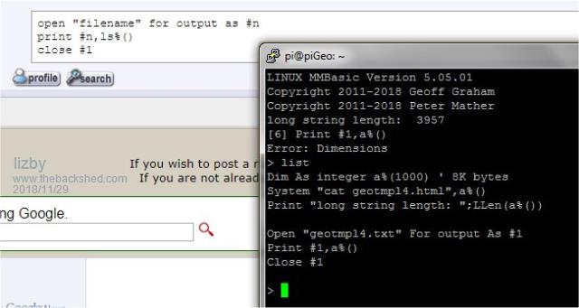

Posted: 07:02pm 28 Nov 2018
What am I doing wrong here?
This statement read a file of 3957 bytes into the long string.
system "cat geotmpl4.html",a%()
But then I couldn't print it. I've been able to process the long strings read in this way.
Edited by lizby 2018-11-30
Posts: 11929
Posted: 07:16pm 28 Nov 2018
  Quote  What am I doing wrong here?
longstring print #1,a%()
Posts: 3884
Posted: 09:47pm 28 Nov 2018
Bingo! Thanks.
