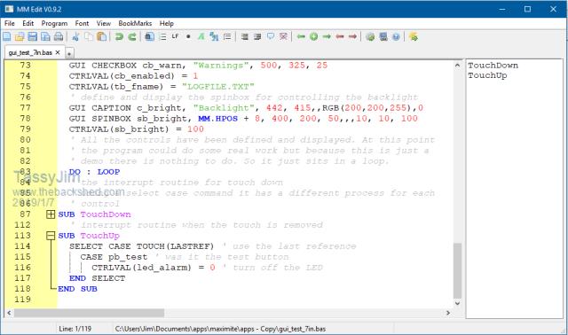

What I want to do is differentiate between the same variable name in different SUB/FUNCTIONs. I will also need to look for DIM statements to do that so something like your request is likely. First, I have to redo the Syntax file system to try and catch up with the ever growing range of devices and MMBasic versions. Without a correct syntax file, looking for user variables is unreliable. Jim VK7JH MMedit |
