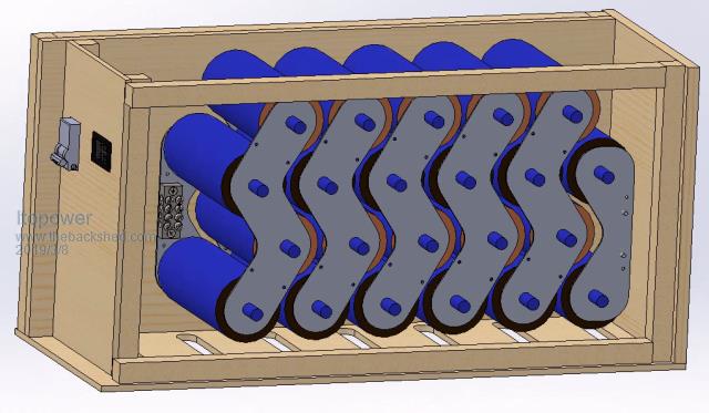

This is the stack of packs...
And this is the internal layout
How many cycles these have had so far, unfortunately no idea. They are still around 90Wh per cell (100%) from a previous test on the whole stack so even though they are 2015 and 2016 cells they are still all good.

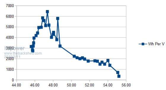

This is an actual discharge test from my pack when it was 26kWh, rather than an individual cell test.
The base axis is busbar voltage and the left axis is Wh per volt reduction. I think this starts to show the actual performance of the cells in a more usefull way.
The noise is due to me switching 1-4kW of heaters on and off while trying to discharge the pack in a day.
