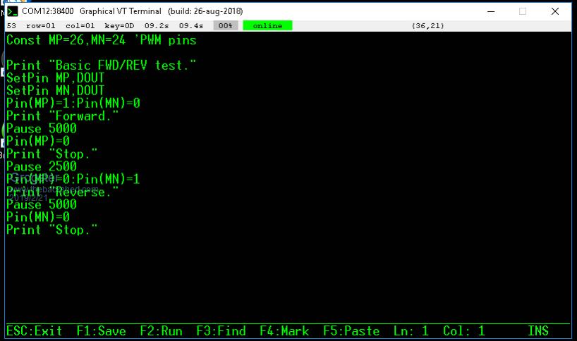

This is tonight's electronic plaything that is having a go at me:

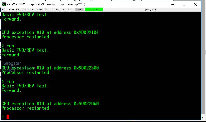

Every time I run the program, I get a DIFFERENT CPU exception, which leaves me scratching my head.
This is the code:
Posts: 6538
Posted: 06:36am 21 Feb 2019
What device?
What firmware version?
what CPU speed?
Posts: 9975
Posted: 06:42am 21 Feb 2019
Sorry.
170 MM2 chip, SSOP
Version 5.04.08
Boot-up speed. 48MHz.

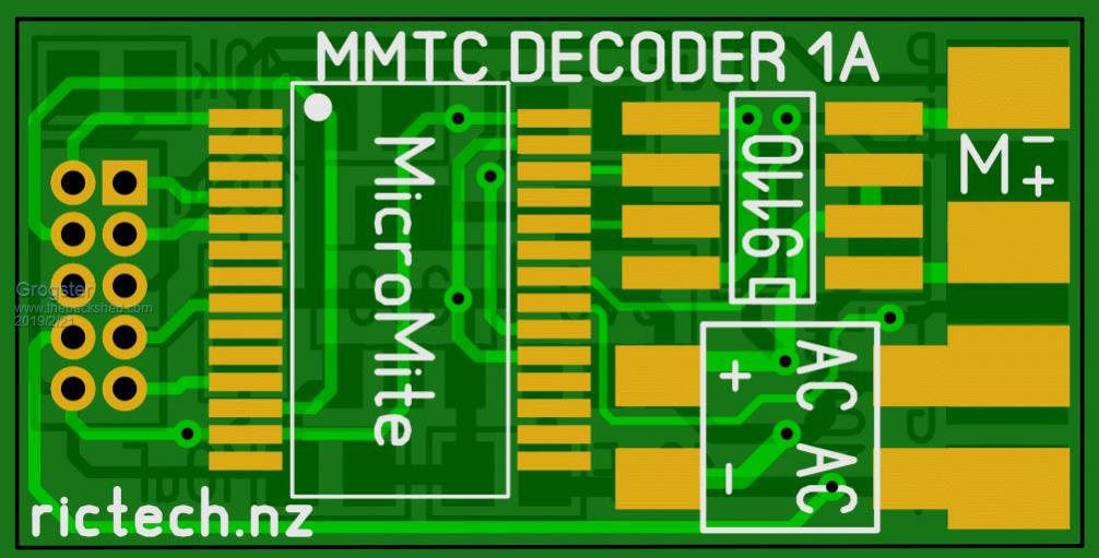

I'm playing with the train-controller thing from a year or so ago:

UPDATE: Problem goes away, if I remove the motor. Perhaps I need a bit of decoupling on the supply, as it is not on the board to save space.
Posts: 6538
Posted: 06:43am 21 Feb 2019
Works OK for me on a MX170 28pin running V5.5.2 speed 40
Posts: 9975
Posted: 06:56am 21 Feb 2019
Yes, I need decoupling. I soldered a 470uF 16v cap across the bridge, and now the motor works fine forward and reverse. The only problem is how do I fit a nice big juicy decoupling cap on the board... The cap is almost as big as the PCB is.

Forgive me saying so Grogs but "Who the hell does a bridge rectifier without a capacitor ? All you end up with is 100Hz positive going pulses. Hard to predict what the motor will get with an L9110 fed with that. I take it you are using PWM.
Obviously be careful of your DC voltage. It is now the peak @ 1.414 x the RMS value with a suitably sized 'smoothing' capacitor.

[Quote=mikeb]Forgive me saying so Grogs but "Who the hell does a bridge rectifier without a capacitor ?[/Quote]
Well....an idiot.
Yes, that would be me....
I think this is certainly where the problem is, but I just did not have the physical room for one. I will look at improving this bad design.

I have no experience with the 9110 but I would have thought it would be quite happy with "lumpy dc" but the 12V limit is going to be a killer.
Is there any good reason to use ac. A regulated SMPS at 11.99V could be a good thing.

When I was playing with these modules, I was actually running them from DC, so in some ways, this should not have been an issue. I think the REAL problem was that without the reservoir cap on the board, when you try to PWM the motor, the load causes a little voltage drop, and that is enough to piss off the processor.
When driving motors, I would have liked to include around 1000uF/100n, but there was simply no room on the PCB. I might just have to stick with soldering the electro across the bridge and leave it at that. So long as I can get it inside the model....
