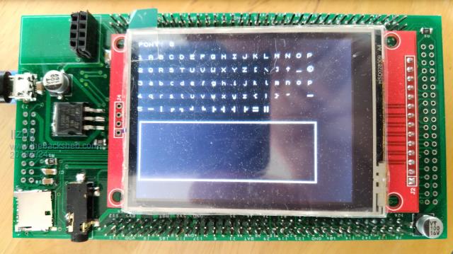

Following up on matherp's micro-font thread which I pretty much hijacked, here is an 8x8 font with the single-line "box drawing" graphics characters based on those of the old IBM PC Code Page 437 encoding.
Below is the program which drew that screen, including the font definition. I placed the characters not where they are on Code Page 437, but right above the normal ascii characters, positions 128-139 (&h80-&h8B).
As I said in the other thread, it may seem silly to want these characters on a device which has the true graphics ability of the micromite, but I had a use for them, it familiarized me to a degree with how fonts are defined in MMBasic, and I had fun. What more can you ask?

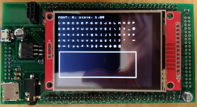

Posts: 3784
Posted: 05:51pm 23 Feb 2019
Corrected because I had horizontal uptic and downtic wrong. Also added "+". Code has been corrected in first post, but CG was too quick for me to get the photo corrected.
(Note that "Scale" in the photo is not effective--only values 1-15 are allowed.)

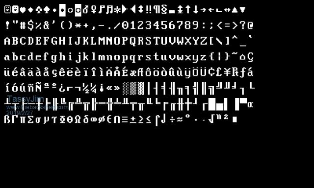

Posts: 6538
Posted: 11:55pm 25 Feb 2019
4 more line drawing fonts
These are all the upper 127 characters of the IBM fonts.
Sizes are 8x8, 8x14, 8x16, 9x16
2019-02-26_094934_IBMfonts.zip

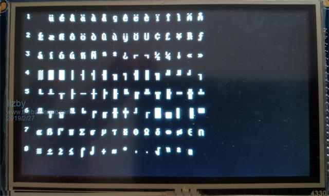

Posts: 3784
Posted: 03:39pm 26 Feb 2019
I ran into various problems with the PC drawing characters at positions above 0x7f--immediately above there some were "magic" characters, so that when I downloaded them, "AUTOSAVE" and "RUN" were invoked. I moved them up 32 positions and still had trouble reading them into an mmbasic program from a file, or inserting strings of them as CONST statements.
My solution was to move them down to the lower case ascii slots, specifically 0x60-0x6e. This eliminates those lower case characters, but they are available by using another 8x8 font. I also added the block character--all bits are 1.
Sorry for the blurryness of the photo. The display itself, a 4.3" SSD1963 on a Nucleo H7 backpack, is quite crisp.

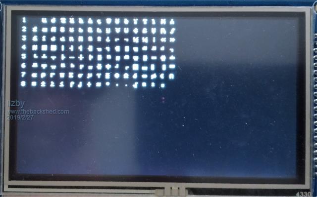

Posts: 3784
Posted: 04:49pm 26 Feb 2019
Thanks for those fonts, Jim. For display purposes, I replaced the first character with a space (all zeros). Here's the 8x8 font.
The program:
[code]

Posts: 3784
Posted: 04:51pm 26 Feb 2019
The 9x16:
[code]
dim string A
dim integer i,j,k,ifont,iStep,nLines,vLoc
cls
ifont=8
font 8
print "font ";ifont;": ";mm.fontheight;" ";mm.fontwidth
for k = 1 to 8
A=str$(k,2,0)+" "
print A
text 0,vLoc,A,L,7,,rgb(white)
A=""
for i = 1 to 16 : A = A + chr$((k-1)*16 + i) + chr$(1) : next i
text mm.fontwidth*3,vLoc,A,L,ifont,,rgb(white)
vLoc=vLoc+mm.fontheight*2
next k

Posts: 6538
Posted: 11:43pm 26 Feb 2019
I thought I would try a font with 254 characters. I wasn't sure if ewe could go above chr$(127). We can.
dim integer x,y,k
cls
font 8
for k = 1 to 255
x = ((k-1) mod 32) * 20 + 20
y = int((k-1) / 32) * 40 + 10
text x,y,chr$(k),c,8,2
next k
save image "Fonts.bmp"
