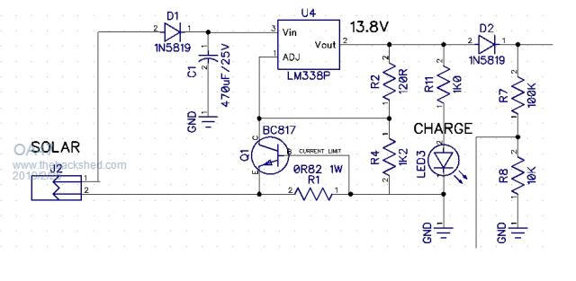

As mentioned in earlier posts I have some MMs radio connected in a star network for in-field data collection. I have been using 12 Volt SLA batteries that are charged by a 10W solar panel. I have been experiencing battery failure which I believe is caused by evaporation of the fluid in the SLA batteries due to consistent dry and hot temperatures. I have been considering using Li-Ion batteries (3*3000mAh) to replace the SLA batteries but I am worried if my simple charging cct can be utilised without too much butchery to the PCB's.
Here is the circuit I am currently using:
Firstly R4 and R2 set the voltage presented to the battery (allowing for D2).
Charging current is limited by the transistor turning on and Imax can be adjusted with the value of R1.
Any discussion appreciated.

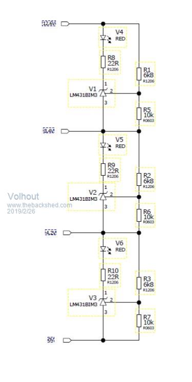

Dear OA47,
Please be aware that a 3 cell lithium ion battery will require a balancer.
Even if the cells are matched to 1% of their capacity, your solar charger will charge them every day (*). Within a year the unbalance will destroy cells.

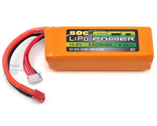

A balancer is not a big complex circuit as long as the capacitance of the batteries is low, but or 3000mA (do you actually need that much to survive the night ?). Here is a picture of a 3S balancer I use for my model airplanes.
From looking at your circuit diagram your charger will charge with 750mA max (that is perfectly fine for 3000mA LiPo). The voltage should change from 13.8V to 12.6V for 3 cell LiPo (3 x 4.2V). Change R4 from 1.2K to 1.1K (1.08k would be optimal, but 1.1K allows for 0.2V drop across D2).
It is interesting to find out why the SLA batteries died. They are quite robust, far more robust than LiPo batteries. They can die of overcharging (not expected with 13.8V) or deep discharge. Well...both are also killing LiPo's. In fact, LiPo's will degrade fast if discharged below 3V per cell (9V for 3 cell). You will need to make provisions to prevent that from happening (cut off power).
The critical parameter is charging voltage. A LiPo cell should never be charged above 4.2V. If there is a difference in capacitance between cells (in series), the difference in cell voltage will get bigger with every charge-discharge cycle. That is why you may not need a balancer in some applications. If a LiPo is only designed to get charged 10x in it's lifetime (i.e. once per year) you may not need a balancer. But at 365 charges per year....you do.

12V laptop batteries have the balancer build in, in most cases implemented inside the chip that also measures the charge, and controls the shut-off FET (in case the battery voltage is drained below 9V this chip disconnects the batteries from the laptop).
The cheaper LiPo batteries do not have a build in balancer. They use chargers with build in balancers. These batteries typically have a large connector with 2 pins, capable of supplying the high currents, and a second connector with 4,5,6,7 etc. pins that provide connection to the individual cells for balancing.
Please be informed that laptop batteries (with controller build in) require software to be usable. Without software the only thing they are usefull for is paperweight.
