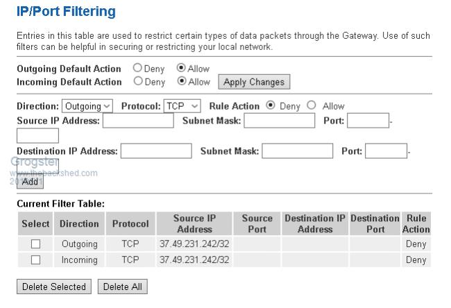

Should I have concern about these alerts?
I don't have a static ip and have not purposely opened the ports mentioned.
  Quote  UDP Packet - Source:37.49.231.242,5693 Destination:121.214.43.14,5080 - [DOS]
UDP Packet - Source:37.49.231.242,5693 Destination:121.214.43.14,6070 - [DOS]
UDP Packet - Source:37.49.231.242,5693 Destination:121.214.43.14,5064 - [DOS]
UDP Packet - Source:37.49.231.242,5693 Destination:121.214.43.14,5066 - [DOS]
UDP Packet - Source:37.49.231.242,5693 Destination:121.214.43.14,10000 - [DOS]
UDP Packet - Source:37.49.231.242 Destination:121.214.43.14 - [PORT SCAN]

A quick search of the IP address on Mr. Google shows that it appears to be from the Netherlands, and it appears to be suspect: LINK
I would be inclined to block that IP address in your router, now that you have discovered the odd behaviour. I am guessing your firewall reported this to you after repeated attempts by that IP address to access your machine, so you should have an option there somewhere to block any further access attempts from that IP address.

If you want to block locally, go into your router's firewall, and then into IP filtering/blocking, and add a couple of rules to block both inward and outgoing traffic to that IP address:
"Rule Action" set to Deny, means the router will just bounce any attempts at incoming from that IP, or for your machine to try to send any response to that IP address.
Agree about the personal IP address. I recommend you take this image down, and replace with plain text, or at least blurr your IP address as this makes you identifiable on the global internet to anyone. The destination address is you on the internet - YOUR IP address. Well, your router's IP address anyway, but it never a good idea to post your own IP address if you can avoid it.

I'm far from experienced at this, but I think "deny" is deprecated because it lets the attacker know that a router is there, providing reason for further exploitation attempts.
It's quite old now, but from time to time I run Steve Gibson's "Shields Up", which probes your ports and reports the results to you: https://www.grc.com/x/ne.dll?rh1dkyd2
