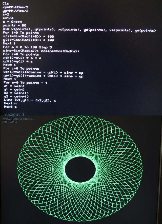

Hi, Im really interested in seeing and experimenting with the line command to make interesting patterns like the nail and string type. I believe these are called polygons for example a octagon with a line going from each corner to the opposite corner. I used to type in short programs for the BBC Micro that showed these patterens. I need to understand algorithms and trigonometry, very hard, so just would like some simple basic code to experiment with. I want to produce something like LOGO or turtle graphics would produce. I also had the Super Expander for the C64 that drew these polygons. The Maximite has the line and circle commands I want to use. I noticed producing ovals and putting them on an angle is really hard with MMBasic. I just want to draw nice patterns, Thanks all :)) Thanks |

Thanks. I never had this trouble with turtle graphice, LOGO, super expander or BBC. There were pre-made code ready to type in and learn from. This way you didnt need a degree in trigonometry and algorithms. I just thought someone out there has some programs to type in and change values for different results. I enjoyed working with the fractal code making dozens of different patterns and using SAVEBMP after it has rendered. I would not have a clue how to make fractals, vectors or polygons using BASIC. If its this hard, you would think after making some code it would be shared on the net for people to use. Why has MMBasic left out the oval command ?, for example oval 35,60,A where a is the angle. I think it was something like that for an ELIPSE. OR. CIRCLE X,Y,A, a being the angle. I will just try line point to point to start with and work from there but I really don't have a good understanding of the maths. Thanks again |

Hi, Thanks for the translation. I tried the code and it didn't work and I haven't found the problem. The way I learn is to look at a program, make changes and tinker with it. I have been looking for pre-made code for the graphics on the Maximite. I have had fun changing the values in the fractal sample but didn't really understand the code. Also. How do I draw a Elipse (ovel) on the maximite ? It only accepts circles. I want to draw an elipse and change the angle it is drawn like on the Micromite. Thanks |
