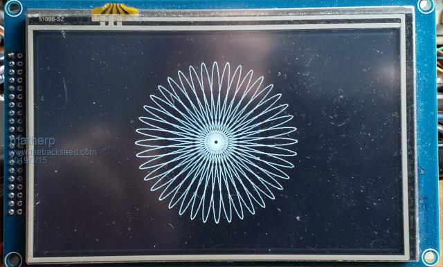

Try running the following extremely simple code
example data on SSD1963: 200,170,80
Option explicit
option default NONE
dim float x,y,t
dim float a, b, p
input "params a,b,p :",a,b,p
cls
do
x=(a-b)*cos(rad(t))+(b-p)*cos((a-b)/b*rad(t))+mm.hres\2
y=(a-b)*SIN(rad(t))-(b-p)*SIN((a-b)/b*rad(t))+mm.vres\2
pixel x,y
t=t+1
loop while not loc(0)

That was my first thought too Jim till I looked at how short the code was. I ran it with my MM+ on a 4" LCD and was surprised at just how fast it all happened. Think I'll have to have a fiddle with it - different colours and stuff too.
Nice job Peter!

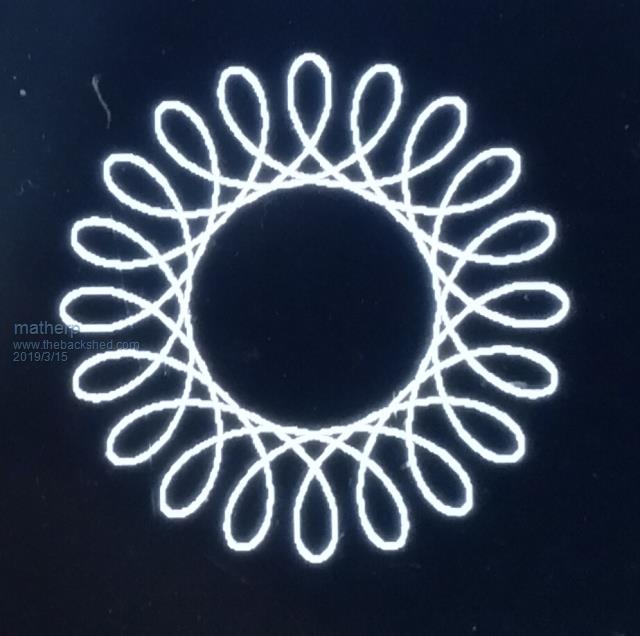

Here is a modified version which uses a recursive calculation of the greatest common denominator of a and b to predict how many petals the design will have and automatically terminates the program when the complete pattern is drawn.
I've put a short pause in the loop so you can see the pattern drawing

200,105,90

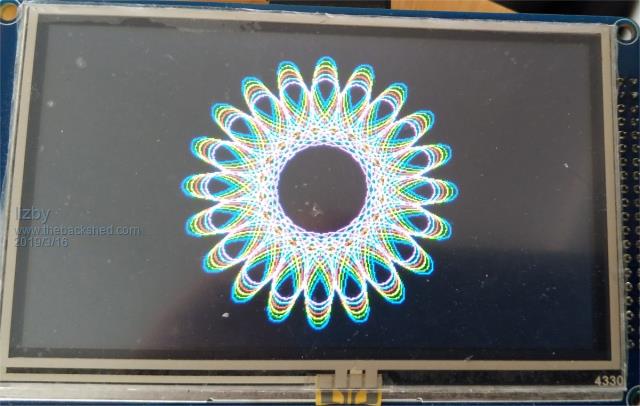

I played colours with your first code - try the one below. I fixed a & b and then there's a parameter 'inc' to auto change 'p' between colours. Using inc=2 makes me feel a bit sick as it progresses, (flowerpower-ish); inc=4 is quite pretty.
Your auto finish code would have been handy here - I just fiddled with 't' till it seemed pretty close.
Greg
'MatherP's Spirograph - https://www.thebackshed.com/forum/forum_posts.asp?TID=11232&PN=1
'try 200,170,80 as the parameters
'also try inc=2 & inc=4. 2 is LSD-ish and 4 is pretty!

  paceman said  ... I played colours with your first code
Nice on a 4.3" SSD1963 on an H7 backpack-144:
But I got this:
save "spirograph2.bas"
> run
parameter inc = 4
[22] Pixel x,y,culla(z)
Error: Index out of bounds
Don't know what more should have appeared.

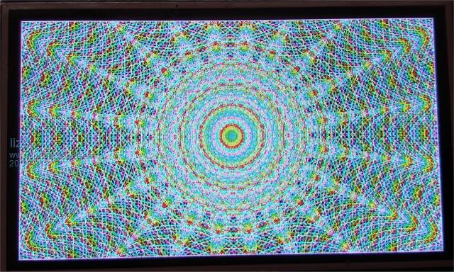

Nothing more Lance, that was it. I was lazy finishing it off. I'm using a 4.3" SSD1963 too - did using inc=2 make your eyes go a bit weird too?

  lizby said   But I got this:
> run
parameter inc = 4
z should maybe wrap around instead of going on incrementing, or the program should stop when it reaches the size of culla()
JohnEdited by JohnS 2019-03-17
paceman
Joined: 07/10/2011
Posts: 1329
Posted: 11:55am 16 Mar 2019
OK, a quick wrap-around. Add the line below as the second last line, i.e before the 'GOTO change'.
If z=6 then z=0
Stop it with a ctrlZ when you think it's pretty enough.

Interesting indeed, but it would take a video to do it justice with either inc=4 or inc=2.
Ctrl-C terminates.
