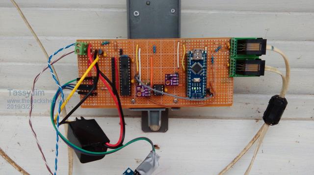

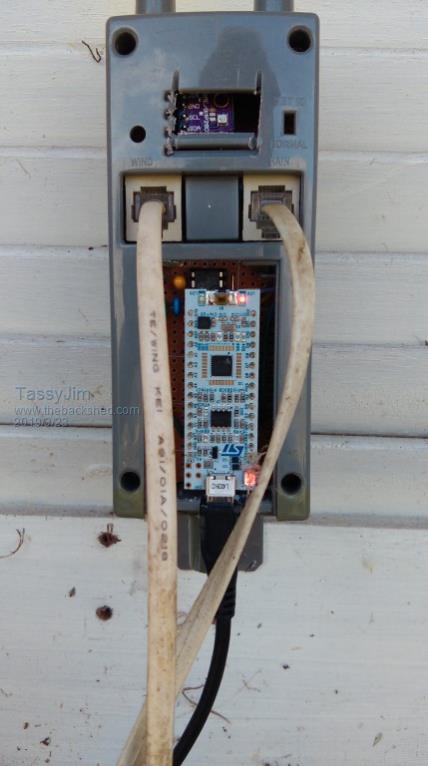

My first rebuild of my weather station used a NucleoL4 squeezed into the original fine offset weather station case.
I had a number of problems with that configuration so I went back to a MX170. The module on the right is an Arduino (WeatherDuino) which shares the wind and rain sensors.
Both the above were housed in a Stevenson screen.
