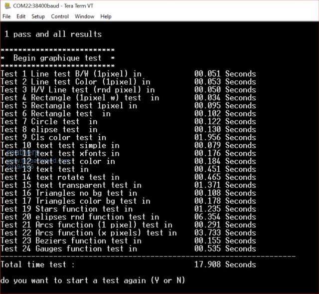

Hi all
here is a program to test the different graphical functions of the PIC32 and STM32 processors
2019-04-25_075632_test_graphic.zip
it is a set of modules (24 maximum) usable or not depending on the version of MM
the software detects the type of processor, the fonts loaded and the presence or absence of files for the "Sprite" function
You can choose to perform all tests or only some tests, as well as the number of repetitions for each test.
You can also run the tests in a permanent loop
this program is open to everyone and everyone can make the changes they want
It can mostly report operating bugs
you can also correct my English spelling errors.
in the zipped file, you will also find 2 files used by the Sprites test program. You must copy them to the SD card

@goc30
Excellent program goc30, it ran perfectly on an E100 running 5.05.02 with an SSD1963 9" LCD.
This would make a great test program to use if a person wants to ensure a graphics screen is working properly.
Thanks for sharing.
Doug.
PS. 24.539 seconds for 100 iteration run on the E100.

Minor tweak to the program to cater for the Armmite F4
2019-04-26_040040_test_graf_v01c.zip
and here are the results on the direct attach ILI9341 (16-bit parallel)
Watch the video
goc30
