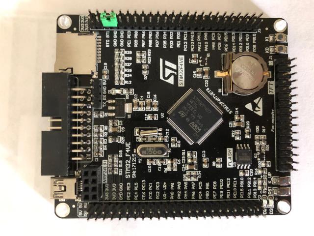

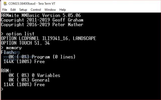

I'm starting to put together the documentation for the Armmite F4 (STM32F407VET6) and the intention is to make it as complete as possible so I will post here the introductory documentation as I write it. This first post concerns programming the MMBasic firmware onto the board. I'm afraid I can't give any advice for Linux users. If anyone wants to replicate this documentation for Linux I will be pleased to include it in the documentation.
Start by downloading the STM32CubeProgrammer software from ST.COM.
If you have an account with ST use it to login and then the download will be active after you have accepted the terms and conditions. If not fill in the form with your name and email address. ST will send you an email with a download link. Click on the link and wait. A web page will be displayed but don't click on anything. After a short period the download will start automatically.

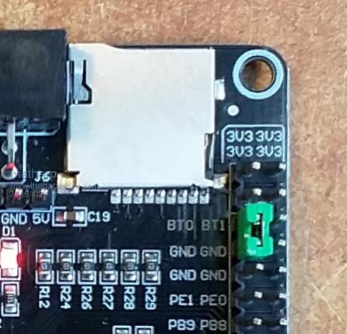

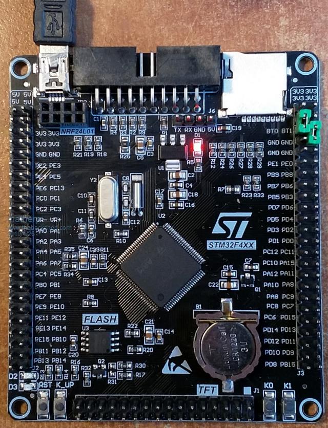

With the STM32F407VET6 development board unplugged set the BT0 and BT1 jumpers as in the picture.

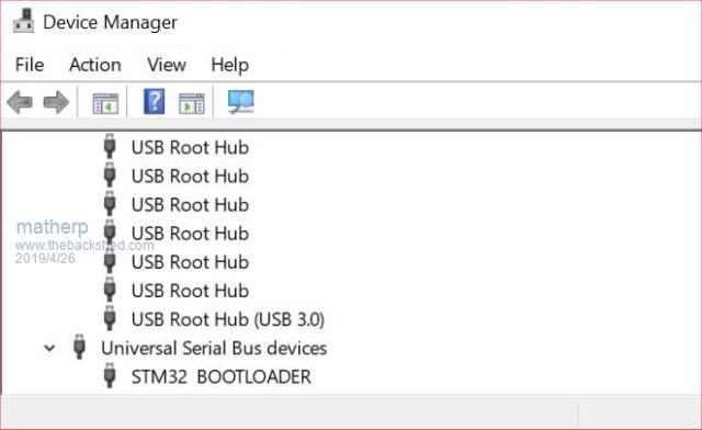

Plug in the USB connector and you should see the STM32Bootloader appear as a new device.

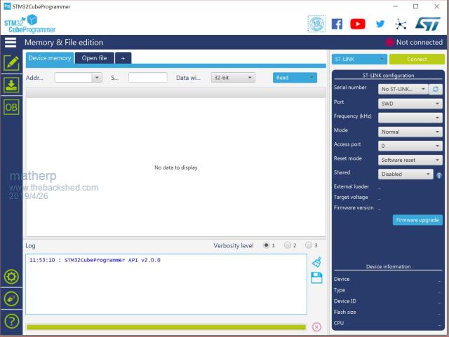

Run STM32CubeProgrammer and you should see the following screen

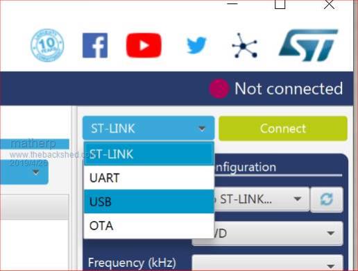

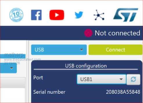

Click the STlink dropdown and select USB
You should see the programmer find the STM32 Download USB device
Click on "Connect"

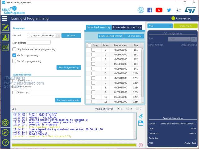

Then click on the download icon

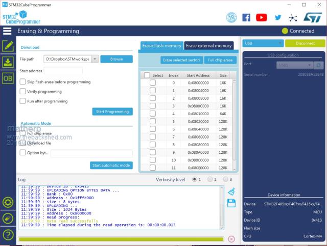

and you will see this screen
Click Browse, navigate to the file ArmmiteF4.hex and select it.
Select "Verify programming" and then click "Start programming"
Congratulations the Armmite firmware is now programmed. You will only need to do this again for a new release. NB: you can also use this program to read existing firmware including option settings (and "saved" variables, if any) and save your own customised HEX file for use on other boards if required.
Now close the STM32CubeProgrammer software and disconnect the USB port. Remove the BT1 link completely and move BT0 to connect to GND

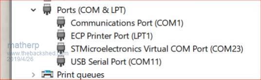

Plug the USB connector back in and the computer should see the ST USB virtual serial port.
If this doesn't happen immediately try pressing the RST button on the board and unplugging and re-plugging the USB connection. Some computers seem to take time to recognise a different device on the same physical USB port.
Connect a terminal emulator to the port and you should see the Armmite copyright banner
If not, press return to wake up the USB connection and it this still doesn't work try disconnecting the terminal emulator and re-connecting, pressing RST, unplugging and re-plugging.
The Armmite firmware controls the CDC connection as follows:
On power up, if no USB connection is plugged in (separate 5V supply) console output will be black-holed.
On power up, if a USB connection is plugged in console output will be buffered until a terminal emulator is connected.
Once running, if the USB connection is removed (separate 5V power) console output is black-holed
Once running, if the USB connection is re-inserted, console output will be restored from the point at which the USB was re-connected.
During development, USB resets can be a nuisance. You can use
OPTION SERIAL CONSOLE ON
to use an external USB/UART connected to the J6 header (just under and to the left of the SDcard slot in the picture above). The pinout on this is compatible with many of the CP2102 USB/UART PCBs which can be plugged directly onto the J6 header. In this mode the USB connection is completely disabled but you can still use the USB connection to power the board.
Use:
OPTION SERIAL CONSOLE OFF
to re-enable USB. In this case the J6 header supports COM1 communications.

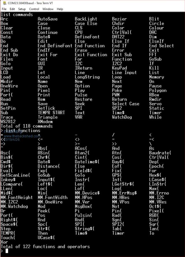

OPTION RESET
You can use two new commands
LIST COMMANDS
LIST FUNCTIONS
to display all the MMBasic functionality available on the ArmmiteF4

Hi Peter,
I was able to download and verify the ArmmiteF4.hex file without any problems. However, after removing the BT1 jumper and grounding the BT0 jumper, I get the following when plugging the board back in
Unknown USB Device (Device Descriptor Request Failed)
Here's a picture of the board I am using
cdeagle
Joined: 22/06/2014
Posts: 270
Posted: 08:13pm 02 May 2019
Hi Peter,
I repeated the entire process again and the board is working now. I'm not sure what I did differently. I have a good memory. It's just short.
