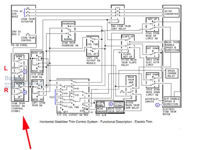

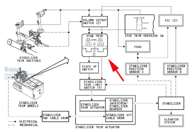

I found the differences (I don't have a copy of the 737NG circuit diagram, but this flow chart shows it clearly enough, and the MAX series switches are clearly evident- a major change (the MCAS system was reactivated several minutes after the first alarm indicators went off, but didn't dial in the fatal excess trim on the elevators until a bit later after they were struggling to wind back the trim by hand- I suspect (as do many pilots and such over at PPrune) that they were attempting to get the NG 'configuration' of electric trim yoke buttons to work with autopilot off, instead they got the MCAS back... and boy was HAL P.O.'d at being turned off, so he drove them into the ground....
MAX
NG
Boppa
