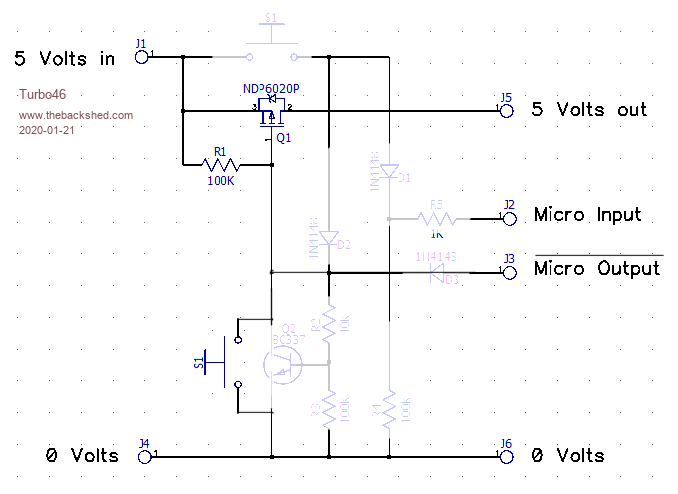

| Andrew_G Guru Joined: 18/10/2016 Location: AustraliaPosts: 883 |
Hi, I'm interested in a simple circuit (simple enough for a Civil Engineer who studied valves at school/uni). Push switch to wake it up and a timer, or Touch, to turn it off (the software I can do). 1) Could "someone" possibly distill the above discussion to produce an updated circuit for a MM2/LCD Backpack?? 2) How best to turn power off to the LCD display whilst leaving the MM running for other tasks? (it would be a subsequent press of a switch to turn off the MM). Many thanks, Andrew (I currently use a battery pack for 5V for an infrequently used project - self contained batteries would be great) |

Hi OA47, I am happy to design a circuit for you, if you want. Please specifiy what your input voltage (and range) is. Specify what you want to keep running in low power mode. Specify what you want to switch off in low power mode. Note that you sometimes can make your life simpler by looking at voltage regulators (5V -> 3.3V) with an enable pin... Some even have "ON-OFF" logic inside them specific for this application, including switch debounce. Regards, Volhout PicomiteVGA PETSCII ROBOTS |

Andrew, Here is my version of the circuit. My NDP6020Ps are still coming via snail mail so I haven't tried it yet. Bearing in mind CaptainBoing's comments above, a TO220 FET capable of passing 20 Amps may be overkill but it should be pretty robust. Also I left the gate resistor at 100K so if there is any suspicion that the circuit does not start up reliably this could be changed to 10K with no problems. Just a bit more current drawn while on. I just looked at that Youtube video and the resistor used there appears to be 4K7. Pushing the switch will turn on Q2 via D2 and R2 which will ground the gate of Q1 and turn it on. The first thing the Micro should do is raise the output to logic '1' to hold Q2 on. Set it low to turn the power off. The Micro input can detect subsequent pushes of the switch via D1 and R5. The resistor from the base of Q2 to 0v is necessary to ensure the transistor is fully turned off when there is no input because the diodes D1 and D3 prevent the input signals connecting the base to ground. ![]() The circuit to control other devices is below. ![]() The transistor could be any small signal NPN transistor you have available. Bill Keep safe. Live long and prosper. |
| lizby Guru Joined: 17/05/2016 Location: United StatesPosts: 3782 |
What is the function of R1? PicoMite, Armmite F4, SensorKits, MMBasic Hardware, Games, etc. on FOTS |
| Turbo46 Guru Joined: 24/12/2017 Location: AustraliaPosts: 1693 |
R1 keeps the Vgs (Gate to Source voltage) below the Gate Threshold Voltage while Q2 is off. For a static (on or off) condition there is no current drawn, so a high value is fine. Minimum gate threshold is -0.4 volts according the the datasheet. During switching, the Gate to Source capacitance must be charged or discharged and current is drawn through R1 to do this. With a lower value of R1 the Gate voltage will fall more quickly and so the FET will turn on more quickly giving a faster output voltage rise time. We are only switching milliamps so the gate voltage does not have to fall very far to fully turn the FET on so I believe the rise time will be OK. Please see CaptainBoing's comments above. @ CaptainBoing, as I said above, I have not kept up with FETs and did not even consider the effect of gate capacitance. Do you have any comments on the above. Bill Keep safe. Live long and prosper. |
