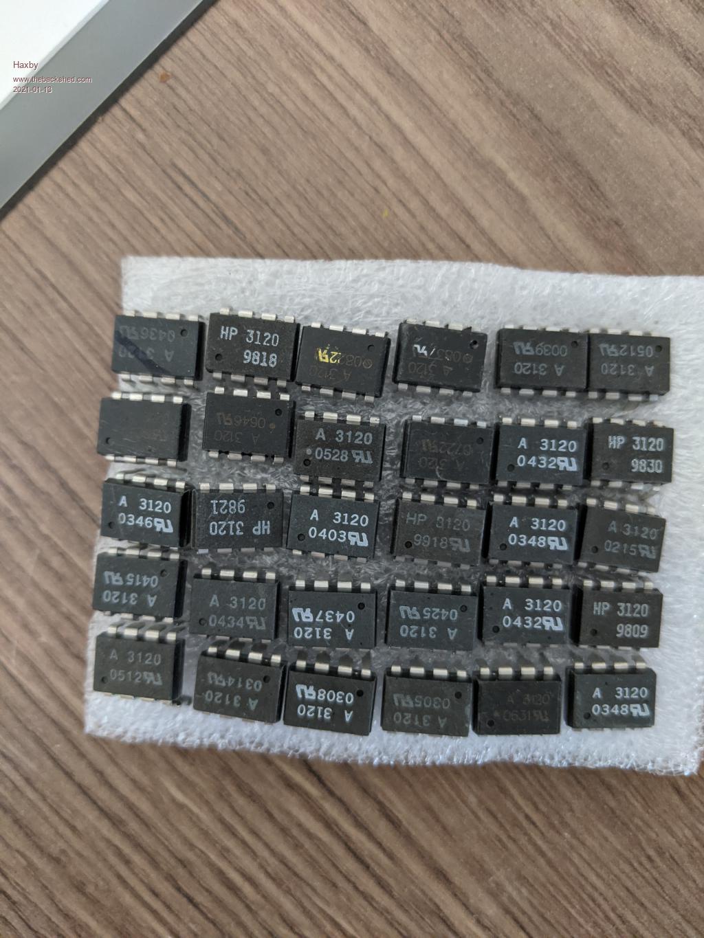

Posted: 02:21am 29 Dec 2020
I have never bought chips from dodgy sources till yesterday actually! Always from Digi-Key, rs, mouser,element14.... We will see what comes in the mail in 3 months time.
when you are trying to get a new design going, you don't want that extra unknown variable in your bug fixing stage.
And if you want the design to work reliably over a long time, you just can't be questioning the quality of the components. Especially electrolytic capacitors and power components.
Now in the last week, as I contemplated building a 3 phase warpverter, I thought that since it will be just for fun and I won't be relying on it, won't be selling it, well, might as well try out cheaper components from AliExpress. Also I don't have a deadline to get something going, so waiting 3 months for some crap to arrive isn't going to annoy me too much.
Well the prices are good..... A tenth of the price of Digi-Key. But I'll be checking every component before it gets soldered, that's for sure.
I bought 60 X hcpl3120 opto drivers at $2.18 per 10 pack! The RS price is $2.90 just for one of the suckers!
Same for IGBTs and MOSFETs.
I still can't bring myself to buy electrolytics from anywhere but the quality places. Even for this hobby project. I've seen too many dry out and fail.
