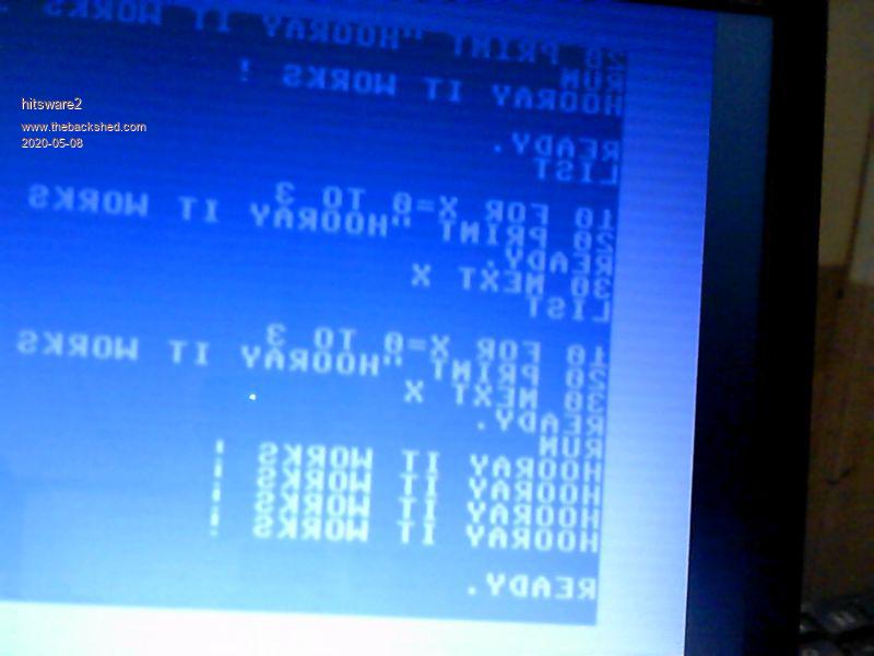

| hitsware2 Guru Joined: 03/08/2019 Location: United StatesPosts: 738 |
. ![]() my site |

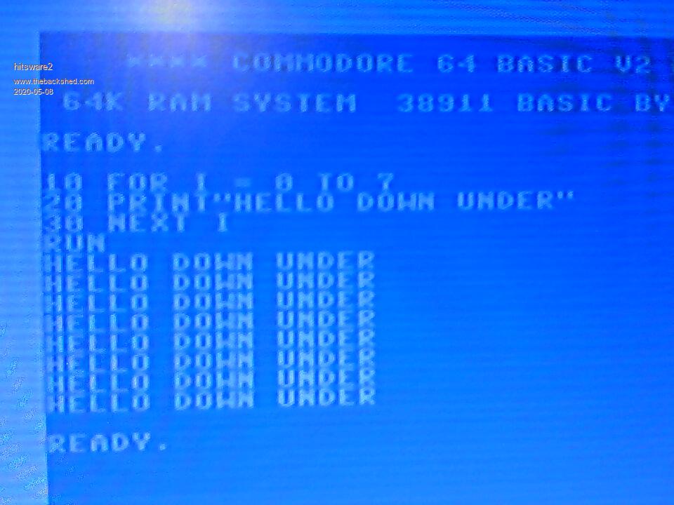

Mega : ) my site |
Good Idea ! Someone must have done that ? my site |
See Here : my site |
