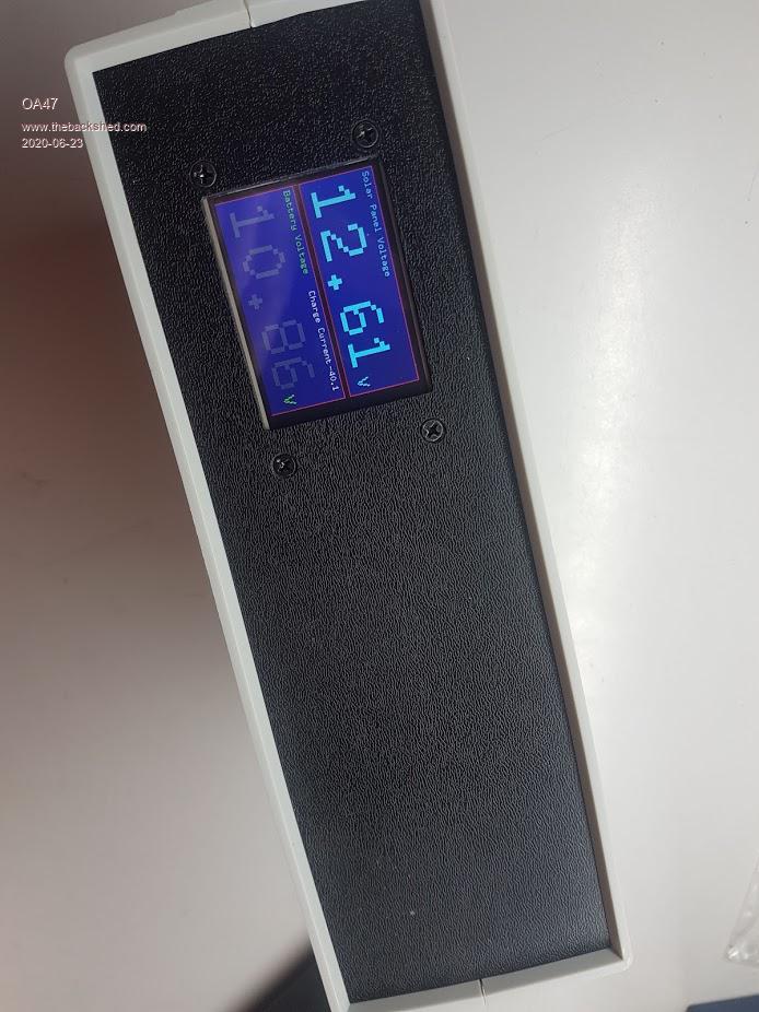

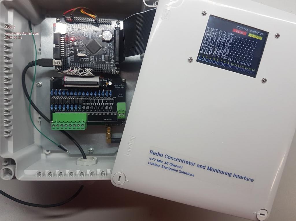

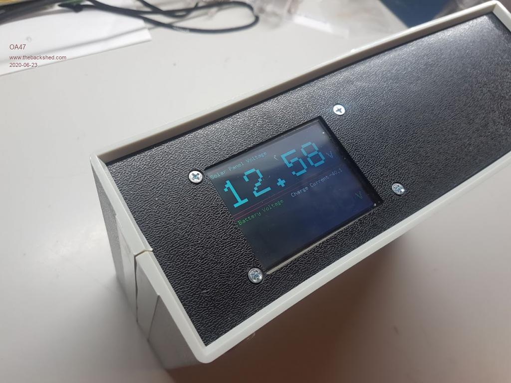

Posted: 10:42pm 22 Jun 2020
  Quote  how about a photo to inspire us cnc newbies ?
3.2" ILI9341
Earlier tests with 2.4 and 2.8 inch in front panels
OA47
zeitfest
Joined: 31/07/2019
Posts: 701
Posted: 03:36am 24 Jun 2020
Nice !
You could probably sell them, the panel-type lcds often seem not to have any way of fixing to panels.
