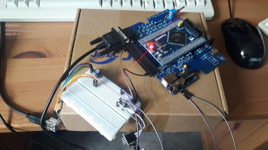

Amnesie
Joined: 30/06/2020
Posts: 584
Posted: 01:49pm 10 Jul 2020
Damn it. In This forum it is not possible to edit the first or a post (much) later on...
Should I open a new topic? I don't know... if anyone has got the same problem he has to read through the whole topic. But I will sum up in this post what I've done and what works.
Let's go:
Problem:now three keyboards only work after re-plugging them or by pushing the "reset-button" right on the Waveshare board.
Is the problem reproducible? Yes, perfectly.
What keyboards I tried?
- Cherry G84-4100 (four of them!) -- Work after reset/replug (support PS/2 & USB)
- Cherry G80-MX1800               -- Work after reset/replug (support PS/2 & USB)
- No Name                         -- don't work at all       (support PS/2 & USB)
- Asus PR1101U                    -- Works all the time!   (only support USB)
Might there some problem with connection / cable?
Absolutely no way! I even tried different kinds of power supplys and cables, also
soldered a thick cables to the board itself. Cleaned the whole board with 99,9% alcohol.
If it would be some bad connection, the whole failure would no be perfectly reproducible.
Could there be too much current draw and therefore a voltage drop which cuts out the USB? This was my first idea, because it seems obvious. But no! I meassured it many time with my amperemeter / multimeter and built in meter in two
different powersupplys.
Has it anything to do with the MC2221 IC? Definitly not, I even unplugged the IC for testing. I even powered the board directly with soldered cables to the usb-type-b connector - no laptop or computer acting as PSU involved.
Does the serial connection work? Yes, without any problems!
Whats about the print mm.info$(keyboard) ? Every time the keyboard works it says "connected", if it not works, it says "not connected".
What is about the different "delay" circuits Jim, John and Rob suggested?
Don't work either. Even Micks suggestion, to hold the reset-button does not
solve the problem.
What is your Vcc ? I tried everything (with the bench top power supply) from 4,8Volts to 5,2 Volts and noticed my keyboards mostly cutting off @ 4,8Volts. Which could be interesting if there _would_ be any voltage drop caused by much current draw - but there istn't any problem!
What happens if you power up the keyboard before booting up
the maximite?
I tried this with a special circuit on breadboard and a few connectors! Don't work
either. My setup is as follows: I am powering the keyboard through my bench top powersupply the datalines (d+ & d-) are fixed / soldered to the usb HOST on the maximite, now I manually powering the maximite via it's 5Vin Pin, so the keyboard had its time to "boot up". But this solves not the problem. I have to completly re-plug the keyboard, then it works. See Image! And yes, this tiny cables are perfectly sufficiant for this current. Before this test configuration I soldered thick wires onto the board! (I should mention to, that of course the whole circuit shares the same GND! So keyboard and maximite is all the same "power-line").
Greetings
Daniel
Edited 2020-07-11 00:30 by Amnesie

Parallelly including a PS/2 access is a great idea.
Hi Andre!
No no no! The IC MC2221 has nothing to do with the keyboard! This IC manages only the serial communication. Previous posts suggested, that this IC only may be the reason for a higher demand of current and therefore causes a voltage drop which is cutting of the usb-keyboard.But again, this applies only if I would power the maximite via laptop or computer, which I don't. I only used this USB-B-type connector as "power outlet for my bench top power supply. If you take a look at the schematic, things will be much clearer. But again this IC is not necessary to operate the Maximite (unless you want to use the serial communication). The HOST-Keybaord connector is not connected to the usb-type-b connector or the MC2221 chip! Maybe this leads to your confusion? You can simply pull this IC out :)
And yes, good old PS/2 function would be great!But I think it would go hand in hand with other problems - but I really don't know... It should be selectable what protocoll we want to use. As first reading that the new CMM2 only supports USB, I was a bit dissapointed - but I understand the reason for that, many people maybe don't have PS/2... In my personal case I have only PS/2 or at least keyboards that support both. Never had problems with the old Maximite and PS/2 ... but with the USB thing... yeah... you see not every keybord works with it. That is not good....
Edited 2020-07-11 01:16 by Amnesie
