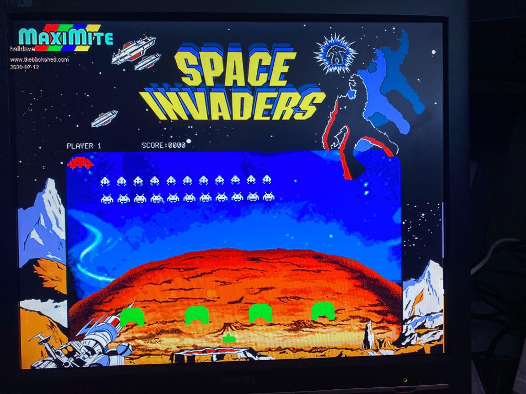

Hi,
I'm currently creating a Space Invaders clone and have a sprite question
There are 55 Aliens displayed on the screen at the start,
1 row of 11 of the the smallest
2 rows of 11 of the middle
2 rows of 11 of the largest
each of these aliens have two animation states
do I load each of these as sprites 1 to 55
then clear each of them and reload the second animation state, or how would you suggest the best way to go about this?
Im two rows in at the moment.

Posted: 03:10am 12 Jul 2020
I've been playing with something similar that requires a lot of sprites.  I have just been overwriting them, and according to the documentation, as they are the same size, it reuses the same buffer.   I've attached it so you can see what I was doing, it isn't usable as is for a final program, it was purely just for experimentation, so no warranties expressed or implied!  I hope to make this into a full game at some stage, but I'm going to start smaller for now.

Wow I love Galaga, so would love to see the final version ,Your code looks like a good start, however I am using the sprite copy command
in your code  where you have
for i = 0 to 19
   sprite read 23 + i, 160, 175, 16, 16
 next
Maybe could work like this
sprite read 23, 160, 175, 16, 16
sprite copy 23,24,19 ' Copy sprite 23 to 24 starting at 24 and a further 18
I wonder in the 64 sprites is a hardware or practical  limit or if you there is someway if it can be increased if many of the sprites reference the same memory.

Posted: 05:52am 12 Jul 2020
  halldave said  Maybe could work like this
Ill keep playing anyway
Yeah I didn't know about the SPRITE COPY command when I wrote that, I'm working through the manual at the moment.
I think it is a practical limit, so it doesn't chew through a lot of memory storing the sprite and the background under it.
Keep on playing, that's what I'm doing.
