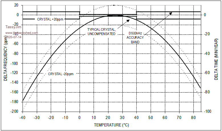

How about the DS3231/3232 RTC modules.
Their precision is quoted as:
Accuracy ±2ppm from 0°C to +40°C
Accuracy ±3.5ppm from -40°C to +85°C
Like all crystals, they will also change over time.
The DS3231/3232 RTC have an aging register so you can trim the frequency to a very close precision but if you do use the aging registers, the nice temperature stability is lost.
At room temperature, a calibrated STM is better.

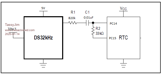

I decide on a different approach for the CMM2.
Because of the way the STM boards uses dropped pulses to adjust the timebase, leaving the oscillator alone, we can combine the wide temperature stability of the DS3232 with the OPTION RTC CALIBRATE command to get a 1pps precision over a wide temperature range.  The best of both worlds.
I decided to use a DS32kHz module. It is the TCXO part of the DS3231/3232 without the aging registers and has the advantage of running its VCC of 5V
I connected VCC to 5V before the power switch so battery is used less often.
The Vbat is connected to the existing Vbat of the CMM2.

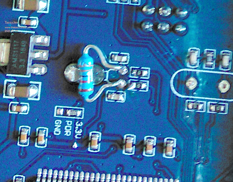

The 32768Hz output of the DS32kHz is connected to the 32kOSCin pin (PC14) via an 820k ohm resistor and 0.01uF capacitor. The existing 32kHz crystal was replaced with a 33k resistor. The resistor is needed to bias the voltage going to the OSC input. It is best placed on the board where the crystal was to minimise lead lengths.
The RC network reduces the oscillator level and reduces the power drain. Important when on battery. The values of 820k and 0.01 seem to give reliable operation on both powered state and standby.
Replace the xal with resistor

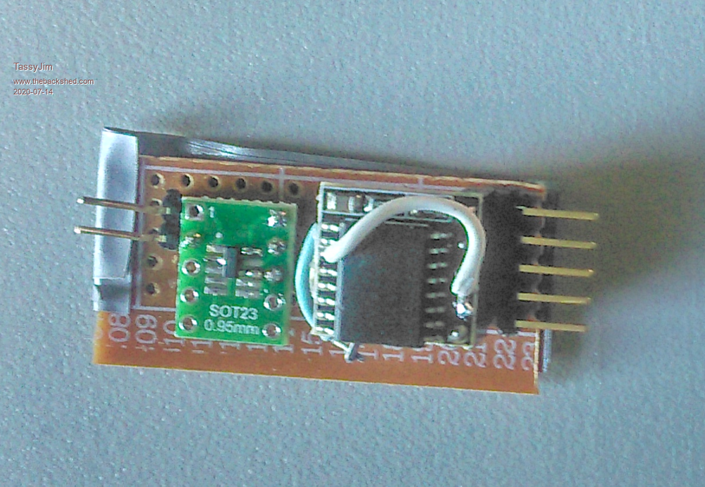

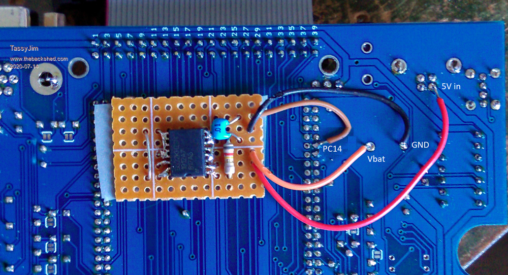

The DS32kHz is available as a 14pin Dip package but my supplier had no stock so I went with the 16pin SO package.
The first assembly used a carrier board so I could use it on a breadboard.
Out of the box, it gave a frequency better than 1ppm. Using OPTION RTC CALIBRATE was on no use in this case.
The second assembly used a chip soldered dead-bug style onto a piece of strip-board.
I had to keep the height down so it would fit under the motherboard when in the case.
Dead bug under the main board. Out of sight!
This module had a slightly worse precision and I was able to trim it using OPTION RTC CALIBRATE -1 to give a precision which is very hard for me to measure.
Over 14 hours, I detected a 1mS change compared to my GPS reference.
Accepting that the next 1mS might be about to appear, I can say that the accuracy is better than 4mS per day or one second in 8 months.
That will do me.
