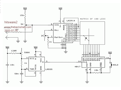

I would like to build ( or perhaps simply program )
a matrix oscilloscope .
Something like :
But more like 64 x 128 ( 255 x 255 ? )
Since higher resolution displays have no pin out to rows and columns
What ( I think ) I need is a display + display controller
+ micro ( processor and / or controller ) that will produce a ' pset '
at the conjunction of 2 8-bit values .
NOT storage of the whole screen , but simulation of a CRT ....
I.E.
oscillator driving 8 bit counter on columns and 8 bit flash A to D
on rows .........

I found good prices for LED modules at this supplier but interfacing to these displays is a little bit involved. A simple arduino can handle smaller modules, more grunt is needed for bigger ones. Because the modules need fast continuous refresh, a Micromite likely can't handle it without internal firmware support. Once the module and controller are figured out, they can be treated like any other display as far as a Micromite is concerned.
Then again, because the modules are shift register driven, it might be possible to do everything with discrete TTL. The tough part is the 'strange' interleaving of the module columns...

It just acts as a standard display using all the normal graphics commands so
PIXEL x,y,colour
lights a specific LED

> Current refresh rate is 62.5FPS on an MX170 Micromite
How would that effect trying to emulate a CRT ?
Doesn't it imply some kind of storage ?
Or do S.S. displays all demand that ?
( I may be getting beyond my technical capacities :( )

Algorithm for this will be: for time base of 10mS
Time_Base = 10
Ms_Time = Actual_Time
For X = 0 to MM.Hres
While (Ms_Time + Time_Base ) < Actual_Time : EndWhile
Show LED at X , ADC Value
Next X
Loop this function if needed ...
Translate this to MMBasic code
Storage in scope function is useless , what you need is the max performance.
Now if you need storage , you have to record each ADC Values in a defined array that you can show it after the measure.
But from what i read here it's not the case ....
