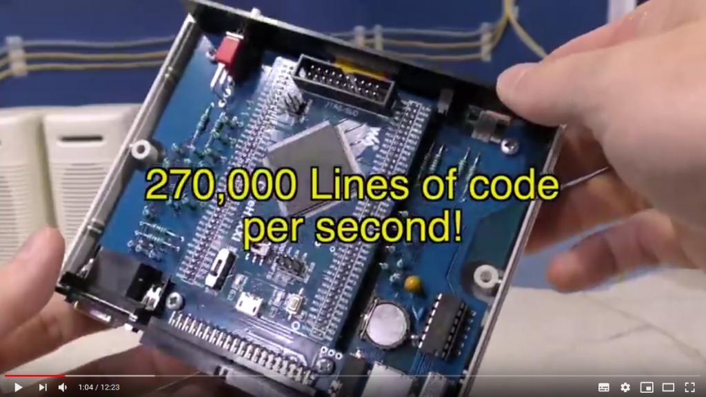

Posted: 02:16pm 16 Jul 2020
https://www.youtube.com/watch?v=IA7REQxohV4
This Guy apparently just took it from here.
  Quote  Full featured BASIC interpreter with double precision floating point, 64-bit integers and string
variables, long variable names, arrays of floats, integers or strings with multiple dimensions, extensive
string handling and user defined subroutines and functions. Typically it will execute a program at
270,000 lines per second.
Colour Maximite 2 User Manual - Page 4
And we need to know how Geoff measured it practically, to have a standard-code for an objective benchmark!

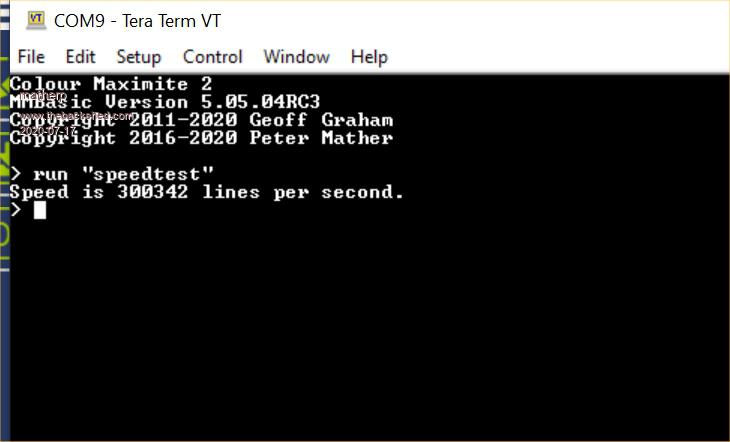

Posts: 11827
Posted: 07:03pm 16 Jul 2020
Coming in RC4

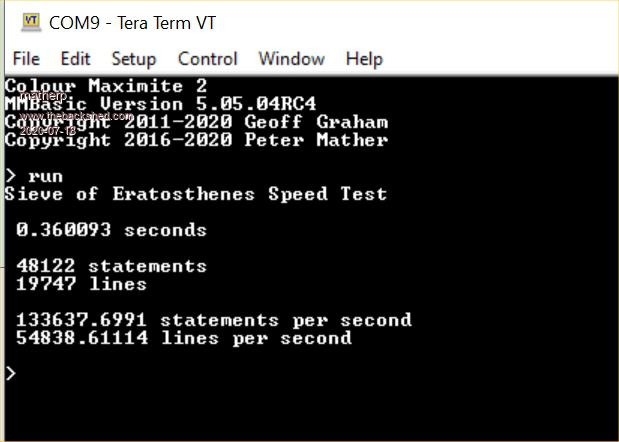

Posted: 01:49am 17 Jul 2020
here is a rather classic speed test:
Print "Sieve of Eratosthenes Speed Test"
Print
Start = Timer
10 W=500:Dim F(W):P=1:A=3
20 F(P)=A:P=P+1:If P>W Then GoTo DONE
30 A=A+2:X=1
40 S=A/F(X):If S=Int(S) Then 30
50 X=X+1:If X<P And F(X)*F(X)<=A Then 40
60 GoTo 20
DONE:
Elapsed = (Timer-Start)/1000
Print Elapsed " seconds"
Print
I = 0 ' statement counter
J = 0 ' line counter
Erase F
110 I=I+4: J=J+1: W=500:Dim F(W):P=1:A=3
120 I=I+3: J=J+1: F(P)=A:P=P+1:If P>W Then GoTo FINI
130 I=I+2: J=J+1: A=A+2:X=1
Print ,P Chr$(13);
140 I=I+2: J=J+1: S=A/F(X):If S=Int(S) Then I=I+1: GoTo 130
150 I=I+2: J=J+1: X=X+1:If X<P And F(X)*F(X)<=A Then I=I+1: GoTo 140
160 I=I+1: J=J+1: GoTo 120
FINI:
Print I " statements"
Print J " lines"
Print
Print I / Elapsed " statements per second"
Print J / Elapsed " lines per second"
Print
> run
5.403 seconds
48122 statements
19747 lines
8906.53 statements per second
3654.82 lines per second
with a number of results for many 80's systems here:
http://www.retroprogramming.com/2010/01/8-bit-home-computer-benchmarks.html

Posts: 11827
Posted: 06:33pm 17 Jul 2020
