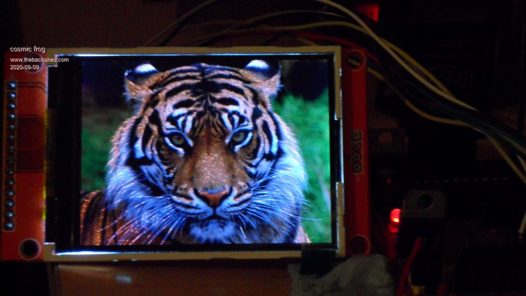

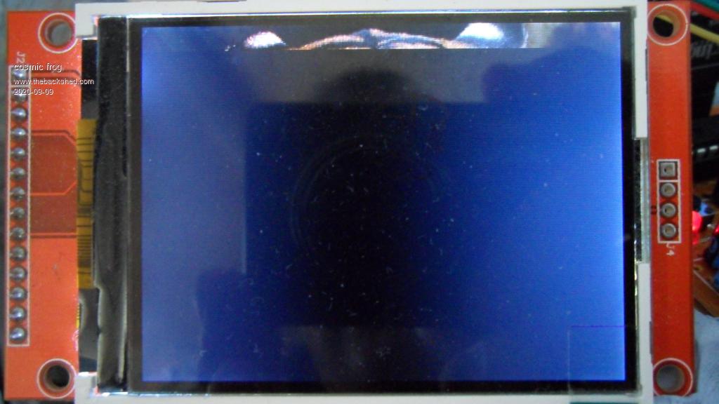

Hi.
I used to use some code written by matherp to display pictures in .ppm format on a ILI9341 LCD panel using an sd card. This code no longer works with the latest firmware for the 28 pin Micromite.
Matherp has released an update but I cannot seem to get it to display .ppm pictures.
Everything else seems to work great.
Any ideas?
Thanks.
Dave.

This is the BASIC code I'm using.
option explicit
option default none
' Version to use the standard SPI port on the Micromite
const mount=0
const fileopen=1
const readfile=2
const writefile=3
const opendir=4
const readdir=5
const CS_PIN=15 'Chip select pin conected to the SD card
cls
displaypicture("tiger2.ppm",0,0)
end

And I'm using it with this C code.
sub mm.startup
' include initialisation for display driver here if required
sdcard 0,15 'set up the chip select pin (cs) for the SDcard eg.0,2 for pin 2 on the chip.
end sub
sub load(f$)
sdcard 6,f$
end
end sub
sub save(f$)
sdcard 7,f$
end sub

Installed the latest firmware v.5.05.03 and using 2016-04-01_152624_newpic.zip
gives me this on the screen -

Finally got it working!
Turns out it was the SD card
I was using an old 1gig card, changed it for a new 32gig and it worked first time
Dave.
