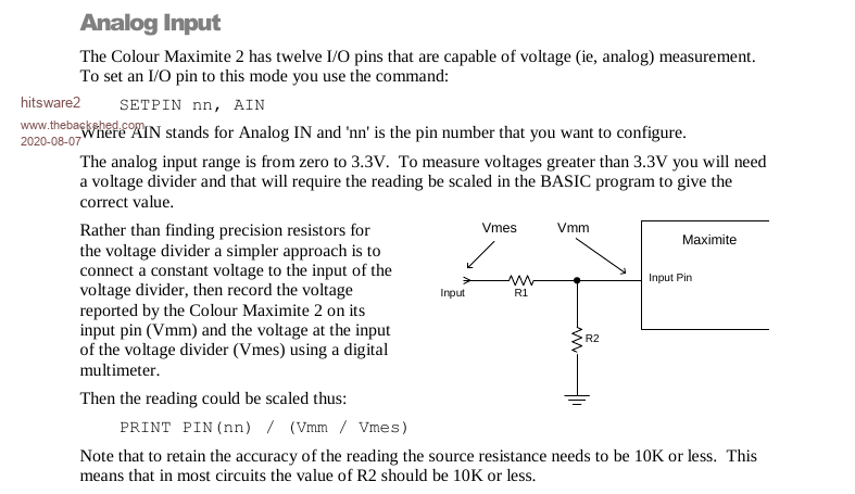

Would do it , but there seems ( from user manual )
much further complications ( and even different commands )

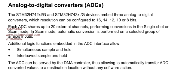

From chip description  :

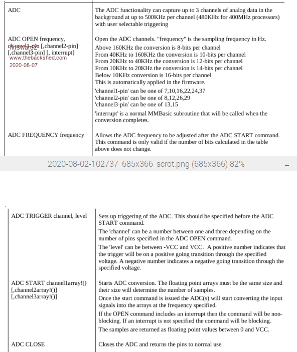

From programming manual :
From user manual :

That is what the ADC command is perfect for.
It reads the pin in the background and fills an array for you. All in the background and bloody fast if that's what you need.
The bits/resolution depends on the sampling speed you choose.
You can then concentrate on doing the any maths and displaying that's required.

The time taken using ADC command will be entirely depending on the sample frequency you choose.
Something I haven't tried is reading the array while it's being stored.
For fast sampling, flipping between arrays and using arrays to plot is great but for slow sampling, being able to follow along behind the ADC, grabbing data a few samples behind will be an interesting idea.

No-one has mentioned the impact of setting the ADC accuracy
Try
setpin 7,ain,16
timer=0
for i=0 to 999
a=pin(7)
next i
b=timer
timer=0
for i=0 to 99
next i
print (b-timer)/1000
then
setpin 7,ain,8
timer=0
for i=0 to 999
a=pin(7)
next i
b=timer
timer=0
for i=0 to 99
next i
Edited 2020-08-07 17:44 by matherp

I completely forgot that you can set the ADC bit resolution with the SETPIN command.
I should read the manual more often.
The bits are the resolution of the ADC converter.
8 bit give 256 discrete values, 16 bit gives 65536 discrete values.
In most cases, 16 bit is far more than required. 10 bit should suit your simple graph.
The fewer the number of bits, the faster the conversion can go.

Speaking of manuals .....
The ' user ' manual doesn't even mention
' AIN ' .... Unless I ' m missing it someways ....
Should be not far after ' ADC ' ?
