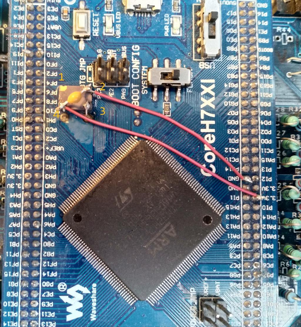

Hi there,
I've soldered together a CMM2 from parts and I'm having an issue with the video output. One display, an old LCD TV, cannot see the VGA signal. Another display, an LCD computer monitor, sees the VGA signal but repeatedly keeps blacking out rendering it unusable. When the image is visible, the video looks great. The firmware also appears to continue running even while the display is blacking out (the machine registers key presses).
There appears to be some dependence on what the firmware is doing - this never happens in the command line mode, and it is especially bad when the cursor is on the third line in the edit mode.
I probed the 5V and 3V3 on an oscilloscope - looks clean and accurate. I've tried different power supplies: PCs, laptops, wall adapters. So far I can't identify any problems visually with the soldering or the components.
Perhaps related: putting my thumb over the crystal pads on the Waveshare board causes the exact same symptom.
Any ideas would be much appreciated. Thanks!

Some monitors are very fussy.
The best fix is to do the Crystal modification.
Replace the 8MHz xal with a 8MHz oscillator module. It is more stable and keeps the vast majority of monitors happy.

I had blacking out issues on my diy board too. Theres a spot under the waveshare board (on the cmm2 pcb) for the xtal ocscillator and 10uf cap, as TassyJim said. I installed these myself the other day (very fiddily) and it worked perfectly.

Thanks for the advice guys! My understanding was that the external oscillator fix was for shimmering / loss of sync issues with video modes that had higher colour depth than the default. The external oscillator is definitely worth trying.

I have done both my boards using the dead bug style like in Peters photo.
You don't have to remove the old crystal so it can all be done without removing the Waveshare module.

I am glad to say that dead-bugging the oscillator as matherp depicted fixed the issue entirely for me. My CMM2 now works at full 800x600 resolution on any display device I try it on. The fix was easy to do. Thank you everyone for your support!
