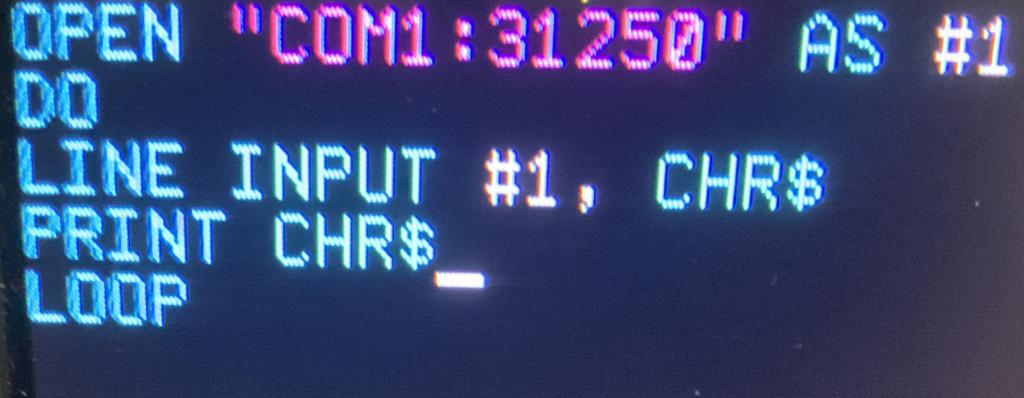

Trying to read a midi signal from com1, the manual doesn’t give much detail on reading com signals so I adapted the basic temperature sensing example, but not getting anything printed to screen when data is sent. I am a total newb at this so probably something I’m overlooking.
I have checked the hardware connections and they are correct and the sending device is sending correctly, so obviously my code is crap

Update - when I send a lot of data I get an error: Line is too long
So it seems like the com 1 is receiving the data but it isn’t printing it to the screen, basically I want it to print each time it receives any data.

Line Input will wait for a carriage return character before returning your input data.  Have a look at the Input$ function.  Also CHR$ is a reserved keyword and shouldn't be used like this.
Try something like this in your do loop:
C$ = Input$(1,#1)
Print C$;

Much thanks @sasquatch I am at least now getting data on the screen, the data is not in the correct format though so I guess now I need to figure out how to convert the raw serial midi input (hex?) to meaningful data, possibly something to do with setting up the com port parameters?

CHR$ is a reserved word. Use a different name for your variable.
Also, what is the physical connection? What are the voltage levels, polarity, etc. The CMM2 (that I think you are using) expects 3.3 volt signals, idle low? High? I'm not sure. What about the midi end?
If the data is coming in as binary, you might want to convert it to something you can see and recognize:
C$ = Input$(1,#1)
Print HEX$(ASC(C$),2) " ";

@vegipete the  physical connection is a midi breakout board operating at 3.3v levels connected to the com 1 pins on cmm2 gpio.
I tried your amendments and I’m getting a constant stream of zeros on the screen, this is good because it means that it is detecting the midi signal, as when I send events they are appearing in the sea of zeros.
I think the default com port settings need changing, the zero I think is the start bit, more info on the midi serial protocol here https://learn.sparkfun.com/tutorials/midi-tutorial/all#the-midi-standard

I don't know MIDI but my quick reading (including the sparkfun site you linked) doesn't seem to indicate that a stream of zeros is normal.
Maybe try the following to ignore zeros and see what is left. This won't work for real data because zero is valid data sometimes but hopefully sensible bytes should be visible when you press a key...
C$ = Input$(1,#1)
CA = ASC(C$)
if CA Print HEX$(CA,2) " ";

if CA  Then Print HEX$(CA,2) " ";
I got a missing Then error message, so added as shown and now it seems to be only reacting to the key press, so thats another bit of progress, thanks Pete. The data is still “garbage” but alphanumeric rather than the random characters from before, so again headed in the right direction, I think the message protocol is going to take a bit of work to decipher, but I’m actually stoked that the data is being read by the CMM2. I have also sent data from the com1 via midi, so already (me being a midi user) the CMM2 is looking like it has lots of interesting possibilities.
