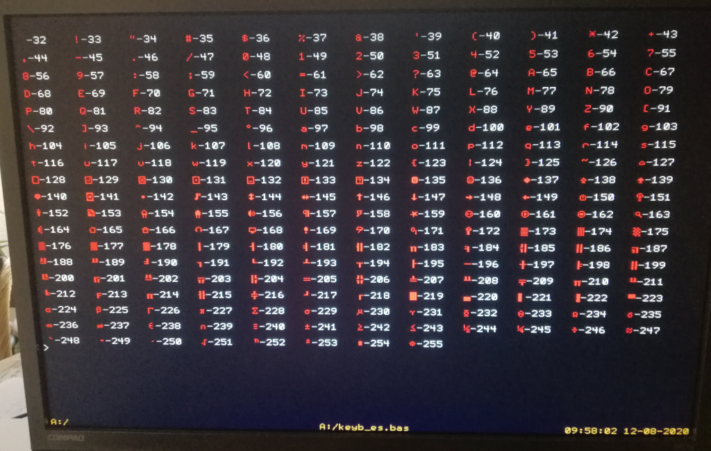

My first program when I receved the CMM2 was:
for n=32 to 255
print chr$(n)
next n
Hmmmm Basically the ES layout works "similar" to US layout, only change some keys:
First row.... from key ~ to = (us layout)
The 9 keys [ { , ; etc....
And the AltGr combinations...
I know about accent letters... I no add none accent combination.
Let me I check for the keys... I post new message.
Thanks for your patiente.

for n=32 to 255
print chr$(n)
next n

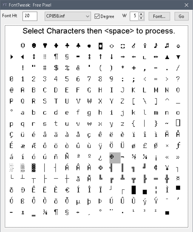

Will always print the built-in font which contains ASCII characters for the lower characters and a selection of various characters for the high number characters.
If you want to print international characters, you can define your own font and then print them using chr$(xx)
The CMM2 will not be able to use unicode or uTF8 to print all international characters.

I used the chr$ from the photo...

You know, spanish keyboard layout have some extra keys:
ç, Ç, ñ, Ñ, ¡, ¿, á, é, í, ó, ú, Á, É, Í, Ó, Ú, à, è, ì, ò, ù, À, È, Ì, Ò, Ù, â,ê,î,ô,û,Â,Ê,Î,Ô,Û,ä,ë,ï,ö,ü,Ä,Ë,Ï,Ö,Ü...
How I add these graphic definition... Using Fontweak ?

Yes.
But you have to do some work.
Before Unicode, Windows/DOS used 'code pages' for the different character sets used around the world.
If you know what code-page matches your language, that is the first step.
Then you have to find the Unicode equivalents for each character. Wikipedia is very useful here.
Once you have the ASCII to Unicode translation list, you can create an INF file file FontTweak.
The last step is finding a TTF font that has the Unicode characters you are interested in. That is easy to do in FontTweak.
One of the code-pages I have translated already might be what you are looking for.
You will still have to use chr$(xx) to print the characters. You 'could' change characters below 128 to print them directly but that would really mess up the whole system so I don't think that it is a good idea.
