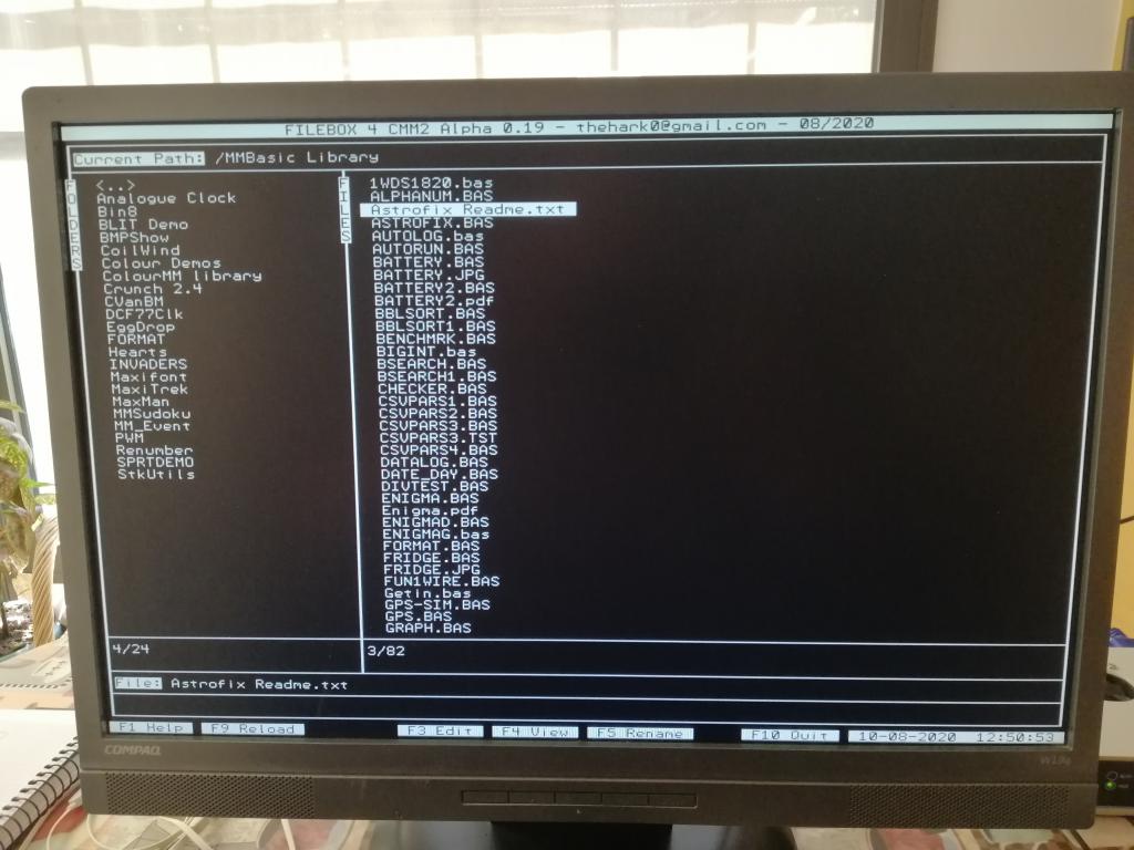

Hello!
I'm working on my own file manager. The goal are a very simple program for copy, move, edit files, etc...
Currently, the program loads and show folders and files. You can create, rename and delete folders (!!! Not delete full folders). I don't know how "trap the error" about folder with contents. I need some explanation about ON ERROR options.
Many options not are implemented yet.... copy, move, etc files....
Not work in terminal mode... I'm are using TEXT for print screen.
Not are finished, very alpha.... I have some "problems":
- I can't RUN a selected program (BAS). (In memory are filebox.bas,... hmmmm how unload?)
- I can't EDIT a selected file... same as previous.
Some help about how to implement these functions are welcome.
Thanks in advance.
PS: I add the source code (22 Kb).
FILEBOX19.zip

Very cool looking file manager! I'm not too sure on how you'd go about implementing running and editing of files.
Some features I would personally like, if you're open for suggestions, is the ability to hide certain file types, have it colour coded, sort by name or type and bulk rename (rename all pngs for example). Oh and displaying a HEX table for the files like for example
0000: 89 50 4E 47 00 00 00 00 00 00 00 00 00 00 00 00 |.PNG............
0001: FF FF FF FF FF FF FF FF FF FF FF FF FF FF FF FF |................
Didn't know how much I wanted something like this until I starting typing...
Just had a thought... You could potentially write your own editor inside the file manager? At least then you could edit the files.
Anyway, keep it up and good luck. looks great so far!

  Atomizer_Zero said  Very cool looking file manager! I'm not too sure on how you'd go about implementing running and editing of files.
Hmmm, I think EDIT can be solved loading the file into the program... basically "adding a simple editor"... not the initial goal of the project.
RUN are more difficult to implement.
Yes, the program have many possiblilities, this is my first code program for CMM2... ;-)
It is precisely what I have commented at the beginning of the post. I think for now I will focus on the functions related to files (move, copy, ...) the basics.

  Hark0 said  Hello!
Thanks in advance.
FILEBOX19.zip
So long as the file name doesn't contain any tricky characters (e.g. quote marks, maybe new lines, not sure what else) you can use execute with a run command:
quote$=chr$(34)
cmd$="run "+quote$+"myfile.bas"+quote$
execute cmd$
Also I noticed the built in file manager crashed when I tried to make a file copy with a quote mark in it to test this.
Edited 2020-08-11 11:58 by capsikin

Thanks @TassyJim.... I take note of your source.
@capsikin.... EXECUTE Command? hmmmm I go trying things...
