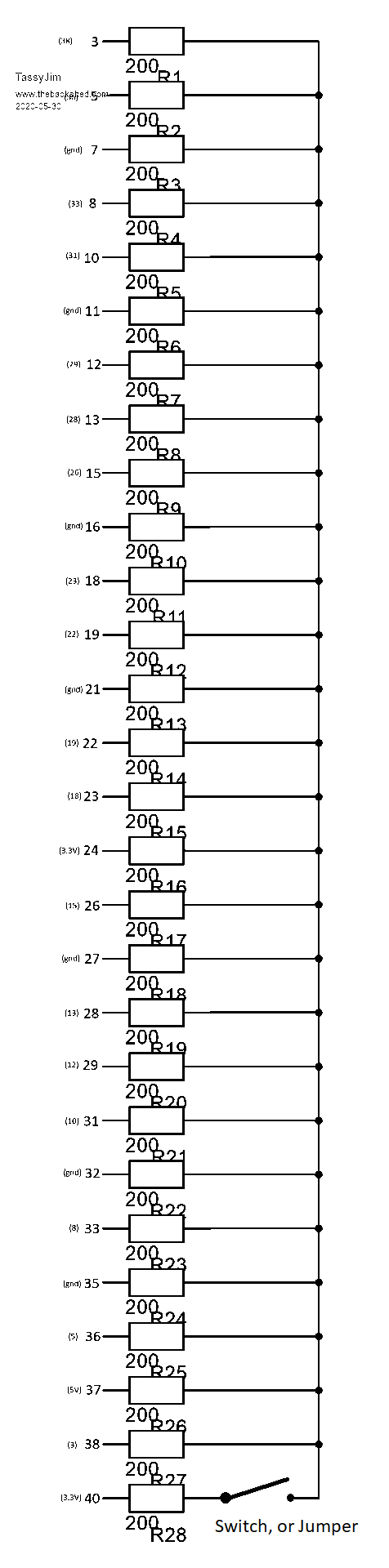

Following on from the saga of building my CMM2, I thought it would be a good idea to test the IO connecter.
  TassyJim said  Not a demo - more a test but I had to put it somewhere.
This tests the wiring of your 40 way connector.
It needs 28 resistors of the same value. I used 200 ohm but anything from 200 to 2k should do the job.
It first checks to see if the cable is the right way around.
Then we test all digital IN and digital OUT.
The analog in is tested by setting one digital OUT high and one LOW to give a voltage at VCC/2.
My fist go was on a breadboard then I got creative with the soldering iron.
Jim's Original Post
This inspired me to break out the "Stripboard" and test the 40way IO connector on my CMM2 v3 Kit.  Rummaging in my leftover components store I came up with twenty eight 1.2K 2% resistors and the other components required to build this tester.
I used this schematic:
Modified from Jim's original to include the recommended switch.
  TassyJim said  The pull-up used during boot to initiate a reset is not strong enough to handle the load my tester puts on it.
When the pin tester is plugged, it keeps pin 40 low during the boot sequence.
When you change some options such as keyboard, the system does a reboot and if my tester is plugged in, you loose all settings.
If that's a problem, you could put a switch on pin 40 and only close it during testing.
  TassyJim said  It SHOULD have a switch.
It is always good practice to plug things in while shut down and that is something I should have allowed for.

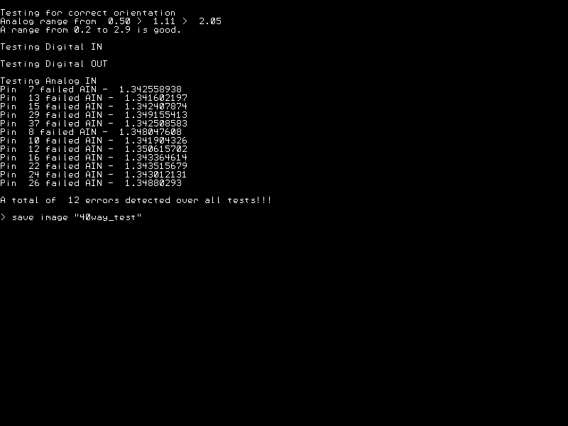

produced this output:
I assume this portion of the program produces the errors:

I am getting an analog reading for V of around 1.34 - 1.35 (volts), which flags as an error.
Is this because I am uisng 1.2K resistors ?
As mentioned elsewhere on the forum I had some problems with my CMM2 build, so it may be that I have some poor solder joints, or have damaged my board with all the rework carried out during the troubleshooting.
I find it interesting that the errors only occur with the Analog Inputs, all 12 of them.  Makes me suspect my 40way IO connector  might be fine, and my resistors are too high a value.
Thoughts please, Thanks

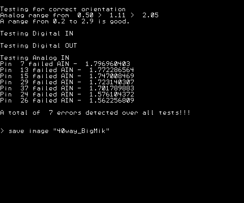

I reported similar to Jim when I started building CMM2 as all of them seemed to fail on at least one AIn by not much (ie mine were 1.57 and the test failed below 1.58) And I found that I worked around this by setting all of the IO as inputs (as opposed to OFF) and the Tests passed.
It is a little bit touch and go, as there are a lot of IO in parallel that can affect the level that is actually presented (via a resistor) from the one output pin.
Jim emailed me and said when he wrote the program it worked on his first board then failed similarly on subsequent boards. His fix was to adjust the Ain range to be between 1.55 and 1.75v
This is basically Jim's fix code however I see your results are around 1.34 so will probably still fail..
Just before the Analog tests you will see 4 lines I added to set unused pins to Din instead of OFF status.. remove the REMs and try with that..
There is definitely a difference between Din and OFF.
I used 220R for mine..

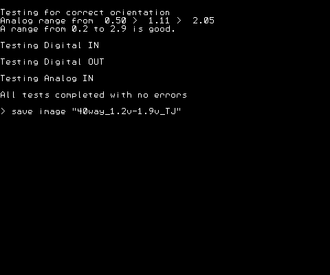

I was too tight with my test for analogue.
change
IF V < 1.58 OR V > 1.7 THEN PRINT "Pin ";testpin ;" failed AIN - ";v : bug = bug+1
to
IF V < 1.25 OR V > 1.9 THEN PRINT "Pin ";testpin ;" failed AIN - ";v : bug = bug+1
The lower the resistance value chosen, the closer the reading will be to Vcc/2
All your pins gave the same result so it is save to say they are working as expected.

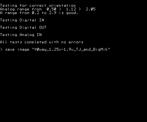

  bigmik said  I would be curious as to your result by removing the REMs that I marked in RED on the above listing.
No problem.  Here is the amended program I used, and the test results:
CMM2_40way_Test.zip
adjust the commented out code to suit.
BigMik's amendment, setting pins to DIN (as shown in red in previous post)
TassyJim's amendment, adjusting the voltage range deemed acceptable (1.25v - 1.9v)
Both the amendments:

That is interesting..
Changing the SetPin to Din instead of OFF changes the reading (in your case) from 1.34v to 1.72 ish results.
But as Jim says it is a rough test for analog reads.. Different resistors would read different values..

Posts: 6606
Posted: 08:01am 13 Aug 2020
Hi Mick,
There are 4 10k resistors on the I2C lines pulling the voltage high.
With low value resistors in the test setup, it is not very evident but with Wombles higher values, we get a significant change.
Its still enough to show which pins are working.
