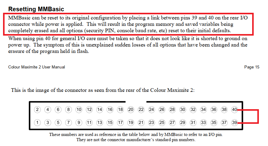

I think I'm being particularly thick tonight
The manual as of 5.05.05b7 states:
I was expecting the CMM2 to be reset to its "original configuration" as stated, and that when I power cycled the machine with pin40 pulled to ground (I used a motherboard jumper across pins 39 & 40) the initial setup program would run, allowing me to select keyboard type, and to set the date and time.
I know that these can be set using:
 from a program or the console
  DATE$ = "DD-MM-YY"
  TIME$ = "HH:MM:SS"
 from the console only, and restarting the CMM2
  OPTION USBKEYBOARD nn
  where nn = UK, US, FR, DE, ES
I have also observed that the last program run displayed on the status bar is cleared, and assume that any other options/settings that I may have changed will have been reset too.
I'm not seeing the initial "setup" program ...  is that normal?
I have been doing so much messing around with the hardware, swapping Waveshares, and failing to identify a duff USB cable, that I had gotten used to seeing that little setup utility when I fired up the machine in a factory fresh state.  Paranoia makes me wonder if everything is working correctly, and I couldnt find the answer (probably because its so obvious) in the documentation.

Popping the battery out of its holder, or swapping the Waveshare board does run the little setup program.  Obviously this also resets any saved settings.
Posts: 6606
Posted: 02:08am 13 Aug 2020
Shorting pin 40 to ground will clear all saved options.
It will not re-run the first run setup. That is normal.
The saved options share the backup battery with the RTC which is why removing the battery also resets the options.
